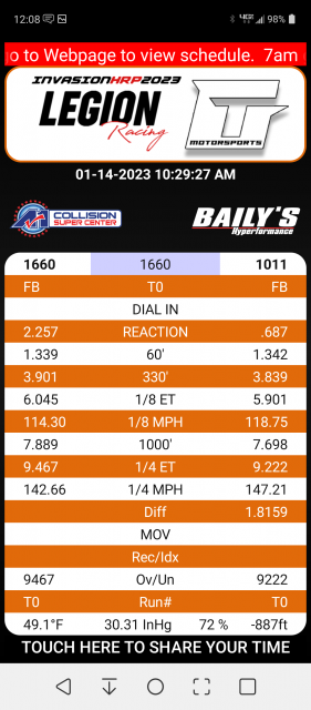

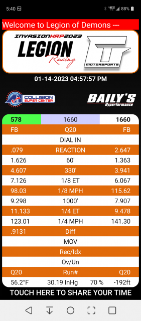

OK, it has been a long challenging day. I did 4 passes in the morning and they were not giving time slips and they were not on the app. The times on the score board were valid but I did not have anyone there taking video for me. But does not matter much since you would not have the 60 foot or 1/8 mile times etc. Such a drag no time slips. They finally got that working and then I went out and got after it and the timing system had a glitch on MY run. The 20 runs before me the info was on the printer and the 20 runs after me was there and my run was just a few random numbers. It sucks because that was a seemingly amazing run. But the car was having a hiccup on the 1-2 and 2-3. Here we go again. So we did a 6 pack so 3 runs back to back. I used the HpTuners to reset the Transmission and Engine adaptives. This seemed to help but not completely. I am pretty sure it was the track prep. It's usually amazing and in a lot of respects it was but there were some aspects that were not on point. Anyhow on the 6 pack the first run was excellent, second run it had a hiccup and 3rd run it spun. So the 2nd and 3rd pass are usually the best runs by far. NOT. Then it spun the next 2 passes after that. So, now it's spinning all the time , scratch my head. Well, there was a huge oil down so a long wait. I went up with a reasonable cooldown and I went to the right lane. The oil down lane, I did not know. Then it happened. I had a record pass, as far as I know, for now anyway. But the thing is it was far from the perfect pass. The oildown was a double edge sword. It helped me hook and run great up to the point of the oil down and then the car was spinning and the Stabillity Control or loss of traction killed my mph and cost me a 9.4X run. Oh damn. Based on my research this pass was down as much as 6 MPH on the 1/4 mile speed. Oh well. Maybe I can get that ideal pass tomorrow.......... View attachment 93479
Your runs are with in .02 from each other so looks like MPH is off. Right lane looks to high in the 1/8th and to low in 1/4 maybe

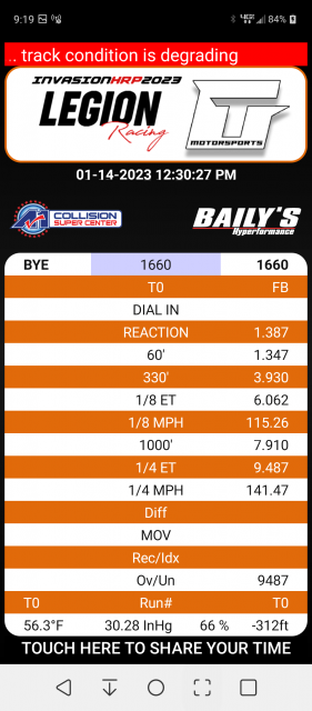

Lots of traction issues Friday. Hope the track is better today

Car ran almost exactly what it should based on the weight I took out since last year. Still more hiccups but a few good passes. Based on incrementals the car would have done 9.4X after 9.4X. But one hiccup and it slows you down about a tenth. I can't really bitch too much. We are so much lighter than OEM I am surprised the stock tuning has held up so well.
Reset the PCM and TCM adaptives again for the second time and I am pretty sure that is what gets the car down the track. But interestingly the fist time I did it the First pass was hiccup free and this time the third pass was hiccup free. Go figure. I honestly think it is just random luck when the tires stay hooked enough to keep the car from a hiccup. The Prep was better today. But if I got up on the converter too much it would spin. Twice I backed up to give it another go and it hooked. So cool they let you back up for a second hit............ 9.467.png 9.478.png 9.487.png
That 1/8 speed is legit and by far a record. What happened is that run was after that massive oil down in that lane. The car was actaully spinning and the stability control was coming on. It was scrunching the tires and it felt like 80 MPH gusts of wind was hitting the car head on. But, I stayed in it because there was no yaw. So that 1/8 speed is correct and the final speed was low by about 6 MPH because of the stability control. Look at the 1/8th mile ET. It matches the speed. Based on the other time slips posted I estimate this run would have been about .01 quicker than that 9.46. I am fine with the 9.46.
