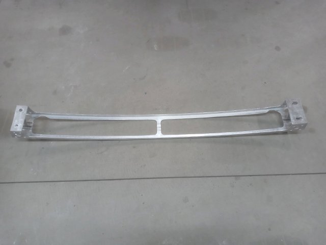

It is aluminum? What was before and after weight? I had been thinking something like this for the front
Yes it is aluminum. I am going to say it saves 8.5 pounds. I did not do before and after weights, but I did take the rems to the recycler and he weighed them at 8 pounds even (I did not take everything, only the big pieces).

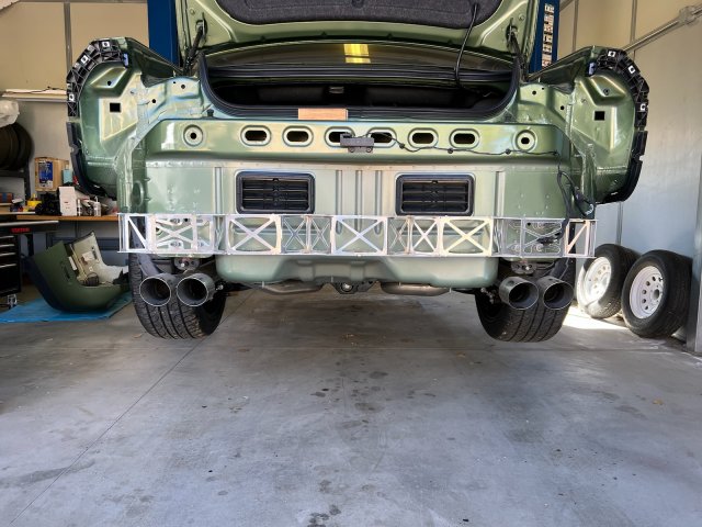

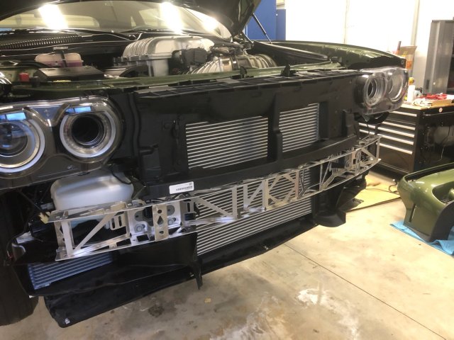

My Friend that sold me the front bumper support also makes a replacement rear. But he did not have them in stock so I cut down my stock one. This is NOT an option for the front for me since it is steel and it is more intricate and would be much harder to cut.
Here is another picture of the front that he makes. It saves 15 pounds. vmacocss05_1292455888616-1-0.jpg
62,442
218,499
The front is a nice looking peice for nearly $500

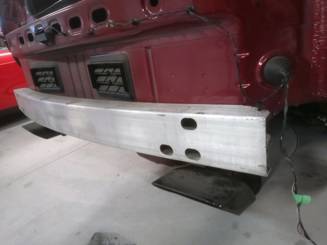

How did you do the rear?

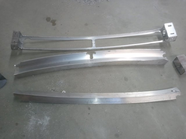

First thing is you have to have a plan. Then you lay out your cut lines. ANd do not cut randomly or you will be scrapping the piece (unless you can weld aluminum). Sawzall off the ends. Cut round holes at all the corners and this also gives you a place to end your cuts and is stronger with less stress risers. Cut out the front with a saber saw. Cut out an access panel in the rear (needs a shorter blade). Also you have to rough cut access for the dremmel tool to reach in and cut/release that center rib. That is the final piece holding everything together. When that back piece falls out you are left with almost nothing! Shocking........
I used a sawzall, Saber Saw, and 2 different size drill motors and bits. And a nice set of Blair cutters, a die grinder with an aluminum cutter to make everything look nice, etc.....
I am going to do another one in a day or two. If you guys want I will take better pics.
I used a sawsall, Saber Saw, and 2 different size drill motors and bits. And a nice set of Blair cutters, a die grinder with an aluminum cutter to make everything look nice, etc.....

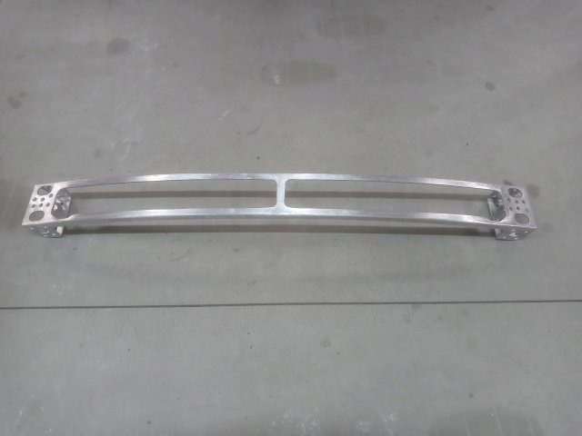

OK, my before weight on my scale is 10.4 pounds. My friend said his weighed 10.5 pounds so they reasonably agree. After was 2.0 pounds. His weighs 2.7 pounds but is WAY stiffer. I pushed down on my car and a car with stock bumper support and could not tell the difference. I don't think outright strength is needed in the back because you do not have the power chiller and oil cooler hanging off the ends like the front does.
Here is a pic of the one he sells on the rear.

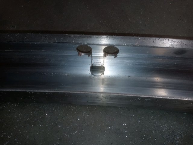

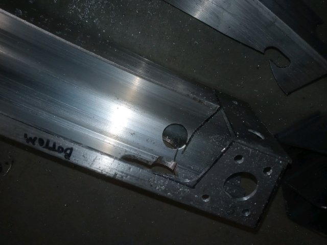

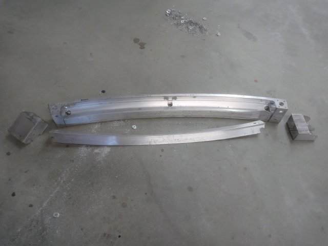

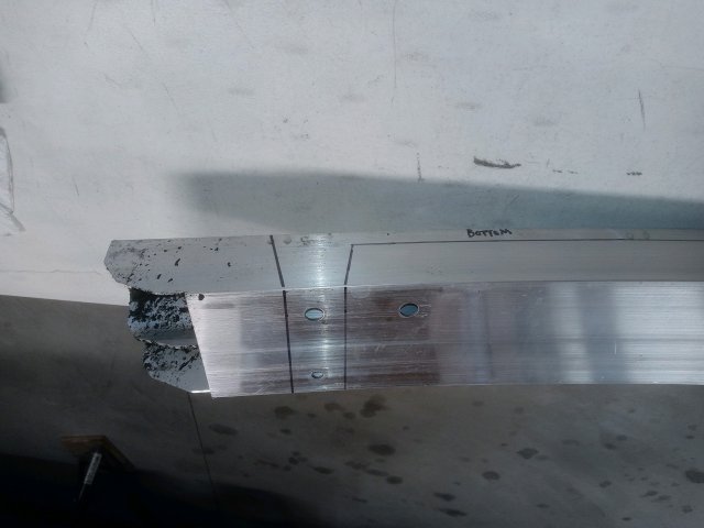

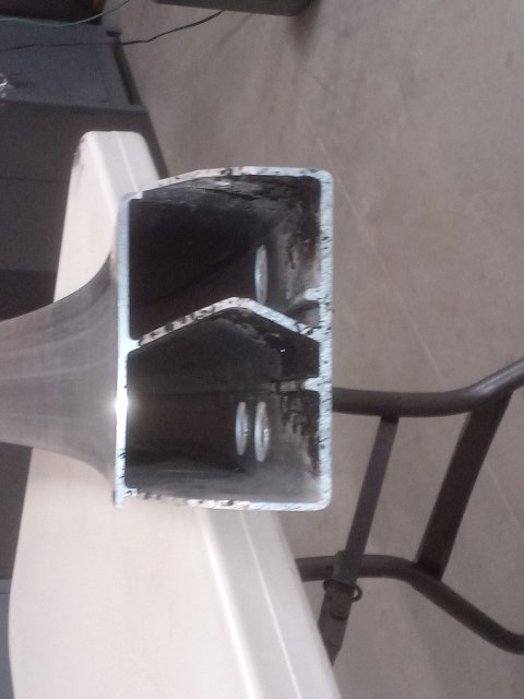

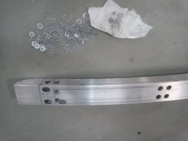

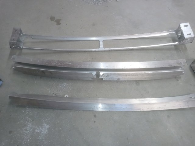

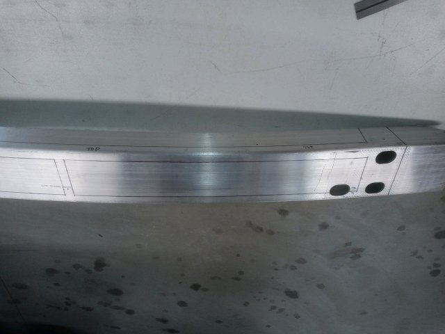

OK the second one I did a nicer job. Of course you learn some things. I drilled and cut some of the lightening holes before cutting the main beam down because once it's all done it is harder to clamp in a vice or hold it still on the floor. I also used a round cutter to intersect my cuts and release the 2 main pieces from each other. That was way easier than a dremmel.
THE END:
THE BEAM: 3.jpg
CUT LINES: 1214220952a.jpg 1214220953.jpg
DRILLED: 1214221338a.jpg
CUT ACCESS TO RELEASE: 1214221436.jpg
FINAL CUTS, YOU CAN ZOOM IN (ABOVE) AND SEE 3 PLACES ROUND INTERSECTING CUTS WERE MADE TO RELEASE THE 2 MAIN PIECES: 1214221444.jpg 1214221444a.jpg 1214221436b.jpg 1214221436d.jpg
ALL DONE MADE NICE: 1214221633.jpg 1214221633a.jpg

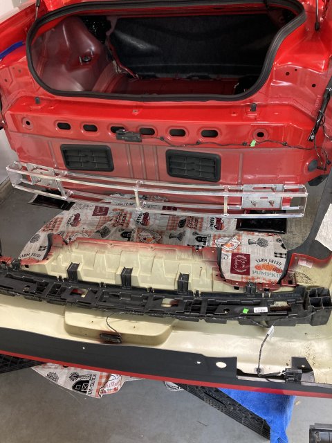

Well, I cut down the stock support so the bumper cover slipped right on. Plus, I cut off the ends and cut off the ends of the absorber as well to match.
Dang it is clean in there. Both these cars have miles on them (11,000, 17,000) and MANY burnouts. So they were filthy and caked on rubber in the outer corners. Probably scraped 1/2 pound of rubber off them both........
All I got to say is "Don't rear end me"!

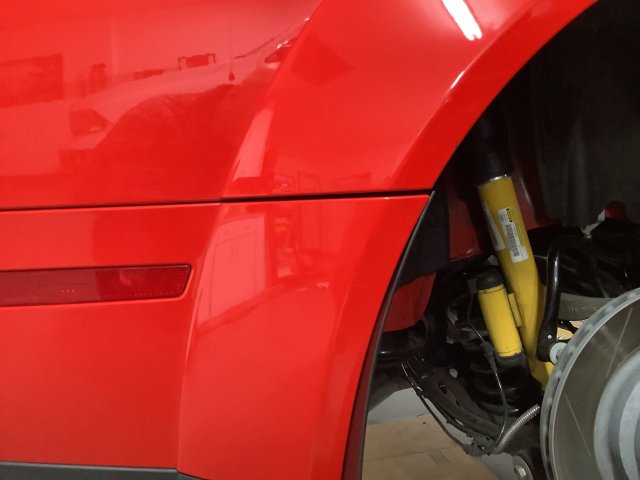

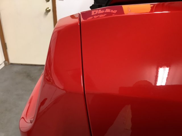

I noticed the gap between the fender flare and the bumper panel seems to be a little bit wider. Probably just my imagination .
DRAGRCR
DRAGRCR
#1181
1,587
5,258
COLUMBUS
KS
MANGO D170
Thread Starter #496
On my car things are still pretty tight. But on my Friends car the fender flare is not lining up good. I wonder if you pushed up on it before tightening that one screw, under the wheel well liner, if it would close that gap some. I am just too lazy to take it all back apart again. I think yours looks normal.

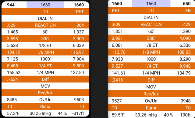

OK, so the car is 100% ready for LOD except for one thing. I had ordered a DCoxR light weight battery to put in it. Well they finally shipped it today 2 day air. So, with that battery in the car I will be 105 pounds lighter than last year. Last year my best was 9.56 @ 141 -780 da. I really hope I can get that record back with a full one seat interior. I would be extatic with a 9.47 but sometimes it is really hard to get all the stars and planets to align. With these cars one thing you have to watch is when the Power Chiller comes on (is enabled at 55 deg ambient). My other car ran 9.58 at +500 da but it was right at that point. It even affects the 60 foot by a couple hundredths. That can be confusing. Right now they are predicting 69 as a high on the 7th when I run the Mason event. So the power chiller will be on for most of that day. It might happen that morning.
