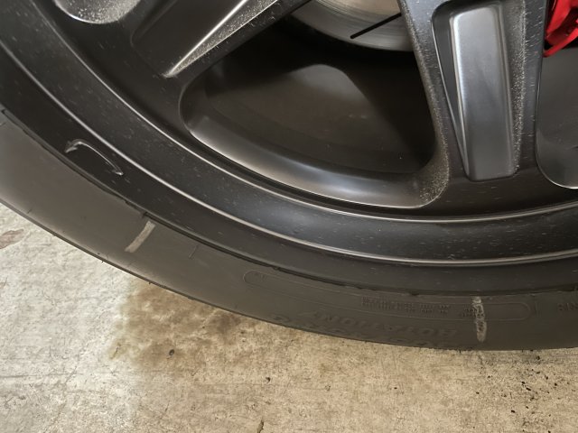

I use hi- tack
They move some first time
This was after 4 passes with some sticky stuff on my beads after thorough cleaning. I have tried a few things, and they always move and get out of balance at the track.
I run about 18 lbs of air and run high 1.49s-1.57s with these tall tires. My stock tires used to move (the drag radials) but not as much, and I pulled mid 1.4s all day with them.
I now have my own at home tire changer/balancer set up, so I will commit to just rebalancing them after each track day.
ALTHOUGH.... when you make 3-6 passes, car shakes a lot in the upper mph, which is terrible & unNerving. $4k beadlocks & matching fronts are not an option with this Biden admin. :-(
