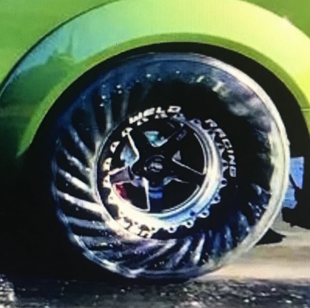

I’ve seen that. I don’t believe it. The minuscule “relief” that a tire slipping a inch on the wheel provides is nothing. More than a inch I would consider a issue and I would be concerned about what the unbalanced wheel vibration does to the transmission under a load. When your trans is ruined… who’s to say that’s not what did it. Beadlocks are there for a reason….. 🤨 46F7C3BB-9125-4BFE-8A5F-C0AD8CFA6DC5.jpeg

Poor sidewall.. it's just begging for mercy. lol
Haha. Yeah that’s not what you want. I would bet that resulted in tire shake. You can only imagine what would happen without a beadlock 😬 High power cars end up ruining the sidewall on radials like that and need to change the tires before they wear down to the wear bars. That’s probably what’s going on there.
