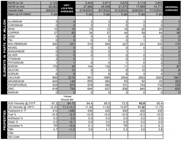

Oil analysis from my Power Wagon 6.4L that has endured this craziness:
Note the copper that is 1/2 that of the universal averages (other people's 6.4s), and further that it has been on a steady decline since ownership (compare current with location average)
Now, the obvious problem is, YOU don't KNOW what THEY did. Again, read my first statement.
