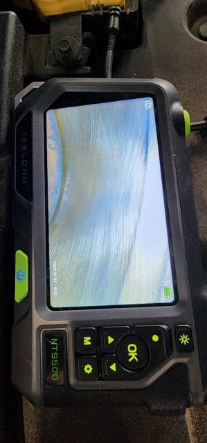

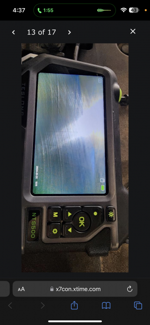

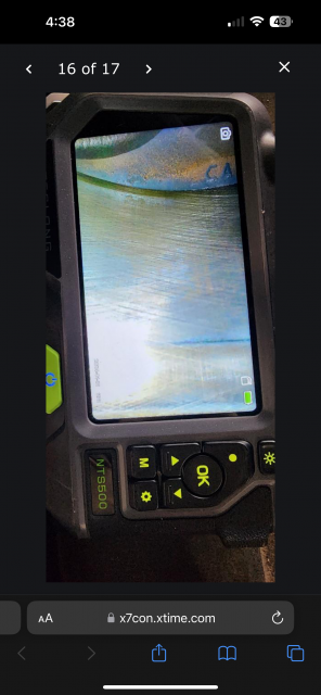

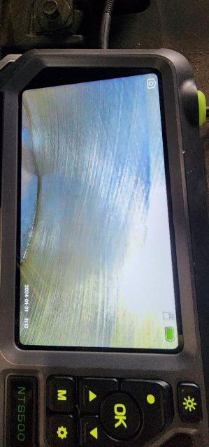

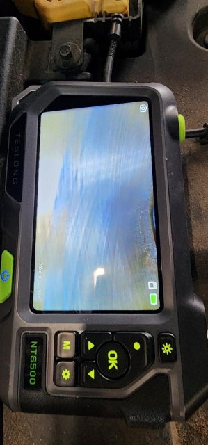

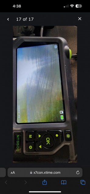

I do some wrenching but I’m not a mechanic by any means should get some more info tomorrow but here are the results from the borescope and compression test.The only thing I noticed was Crank and cam wave pattern was checked no by the tech. I asked for the diagnostic tests to be done for piece of mind since at the time nobody at the dealership seemed to know what actually happened to my car.

I would caution you on demanding a re-paint of the front bumper, I mean it's almost impossible to not scratch the underside up a little over time and those are pretty minimal marks. I only say this because the odds of an exact paint match and it looking perfect are low in my experience.

Dealer sent pictures of bore scope and clearly sent pictures of a different car, date on photos is from January 31st of 2024 and engine bay looks nothing like mine. Waiting on blackstone kit to send out sample. Scheduled appointment for a second opinion.

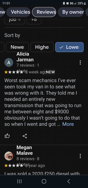

Chrysler Dodge jeep ram in castle rock co,
🤷‍ first review
