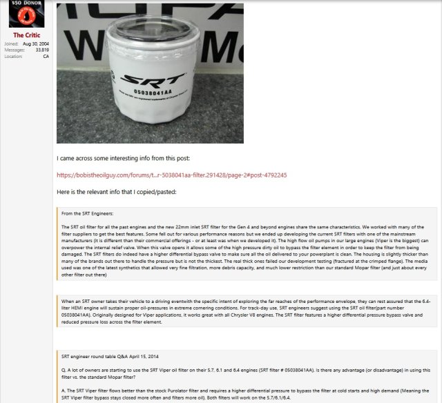

Okay, so I did a search for "SRT Oil Filter" and found this thread:
https://bobistheoilguy.com/forums/threads/use-mopar-srt-oil-filter-for-5-7l-hemi.337705/
The SRT engineers said the SRT filter was used for the Viper. They go on to say:
"For track-day use, SRT engineers suggest using the SRT oil filter (part number 05038041AA). Originally designed for Viper applications, it works great with all Chrysler V8 engines. The SRT filter features a higher differential pressure bypass valve and reduced pressure loss across the filter element."
So the SRT engineers suggested using the SRT oil filter for track use, but didn't say it was otherwise required.

Required? Nada. However this is why some of us like it…

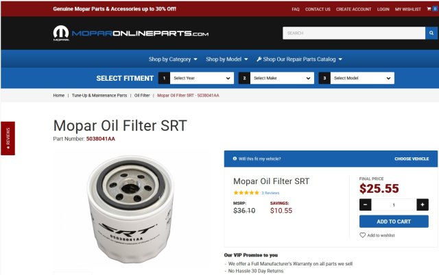

Yikes! (sort of)
So is this the one everyone is using?

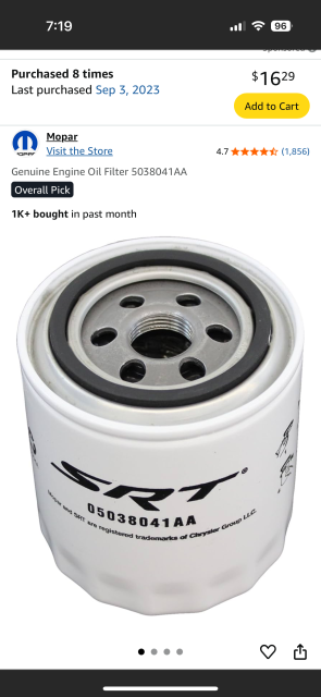

We need to catch you up, you only been with us about a year. Most of us simply have alerted each other here in the Forum when the price on Amazon falls so we can stock up.
I'm still surprised my dealer never mentioned this was available when I went in for an oil change.
