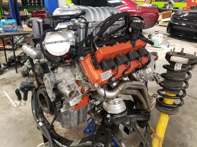

Small hiccup today. Texas speed sent the wrong mid pipe connection. Going to get a hold of them tomorrow and hopefully work to get those parts sent by a space shuttle. We are so close lol.

I'm not sure what is going on here

Taking it home tomorrow for a 500 mile break in, then tuning.

It's home. Needs a quick tune revision to make this quick break in possible. Driveablity isn't "there" at the moment lol.

Small update. Breaking in the motor and then bringing it back to tune. Decided to switch tuning platforms to HPtuners. Diablo cannot make true flex work as of yet. I'm not going to wait longer for the 2020 season. Plan to keep the Diablo PCM/Trinity as I use the Trinity for everyday street "heads up info/logging".
Hope to get this wrapped up in the next couple weeks.
Car is running well so far after a few hundred miles.
