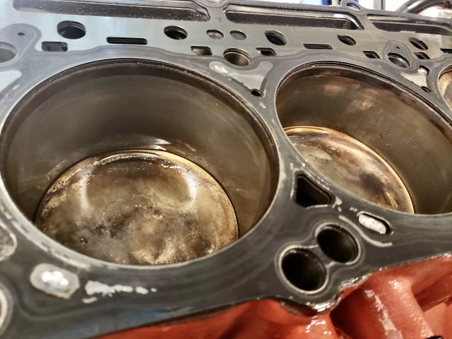

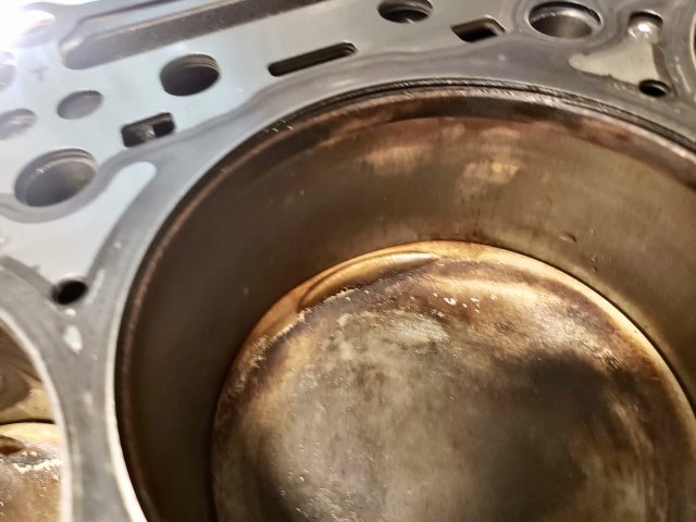

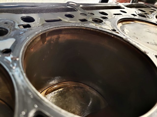

My 2.72 has shown 17-17.5 in good air 16.5 in not so good.
Head gasket?
Head gasket?

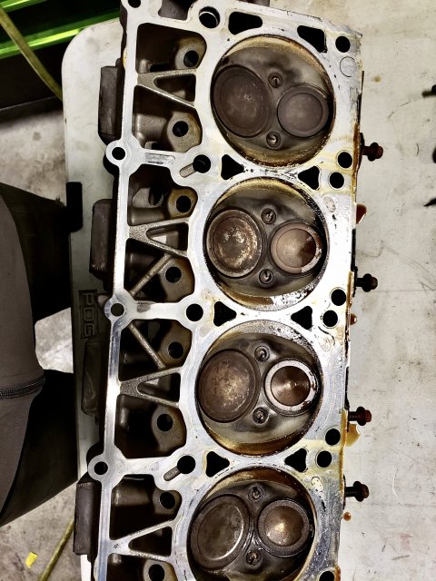

No, I can only assume a lot of condensation for sitting for almost a month and only getting started to move in the parking lot or around the shop.

did you always run ethanol or did you run a tank or 93 sometimes and you said it sit for a month

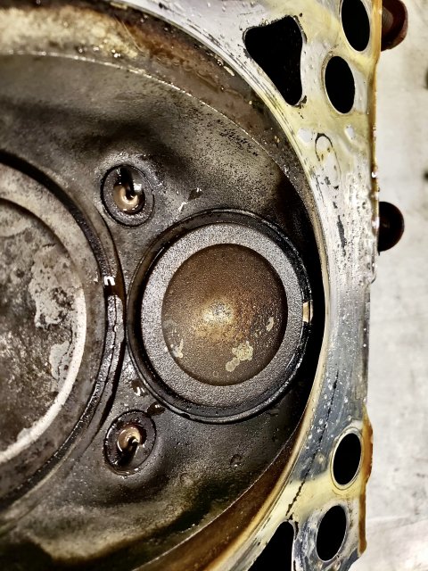

am I seeing that right the valve seats are damaged???
Heads look good from what I can tell. I've been on e85 for a long time all seasons of weather too. Not sure if it's worth doing a tank of 93 now and again.

Thread Starter #27
Looks to be just a water drop when you zoom. Good eye though.
3,361
5,906
Ok from the pic looks just like valve seat bad lol

Was a lifter bad ?

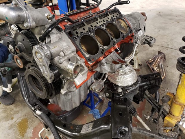

They found some wear patterns on some lifters and the cam. Not sure how marked up they are. I’ll get pics when I can.

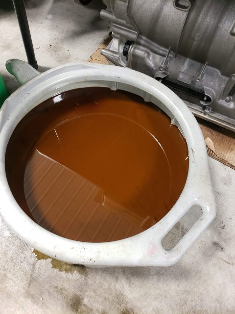

I’m curious to know what you find to be the problem,also how often were you changing the oil ? With ethanol I’m changing mine every 1500-2000 unless I race it a lot then I change it sooner because it runs rich

I was changing about every 3000. From what guys have reported with sending theirs out to blackstone for analysis there was no issues with the oil. I plan to put 10w40 Amsoil in this one after initial break in. Has a bunch of extra goodies in it. In the winter I figure I'll step down to 2k for oil changes. I'm not sure if the short drives not getting to temp to get kids from school, etc. in the winter played a part over the last 3 years with the pre-mature wear of the lifters. Also, I wasn't "easy" on the car in the warm months. Saw a lot of WOT.

Honestly, I don’t see anything wrong with those pics. I’d be surprised to see excessive wear on the lifter or cam at this point too. Some wear, ok, but doubt it’s severe. Did you drive it at all after the dyno session?

I had the option to, but I chose not to considering it was making that valvetrain noise.

Some have it happen. Just saw another post on the Facebook group of what sounds to be like a lifter. Who knows, could be bent pushrod too, but not common on A8 cars unless you are living on the limiter.
