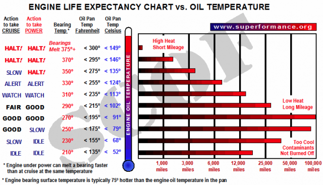

Not a Redeye, but I see in excess of 270 oil temp at the end of a 20 minute track session.
Never noticed the coolant temp doing that on startup, but I'll specifically look for it to see what mine does...
