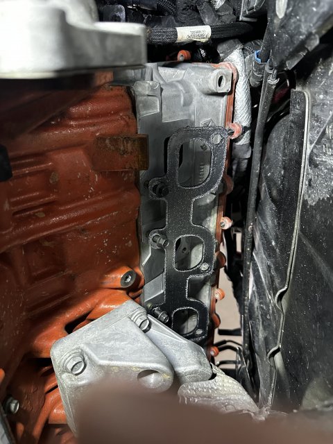

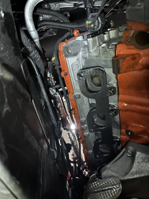

Brake clean, red scotch brite, and remflex gaskets is the way I’m going it seems. I used rtv on my supercharger before and had to use a pry bar to get it off, so no rtv on the headers for me - not enough room

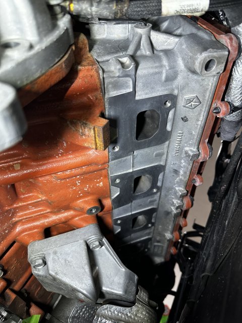

Finally able to get back to it. Nice and clean.

Thanks, definitely took a lot of elbow grease to get the ports clean and all the carbon off. 3m white roloc with 90 degree angle die grinder and red scotch brite sheets. I recommend a little wd 40 with the bristle disc, scubs more instead of marring the surface
Perfect, credit for doing it in the car. That makes it pita. Everything looks clean. 👌

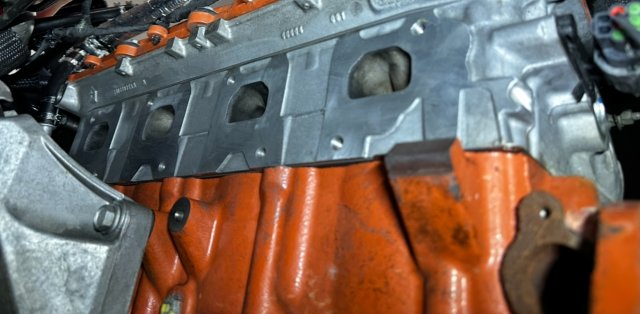

Die grinder won’t work with the front 2 ports unfortunately

Thread Starter #115

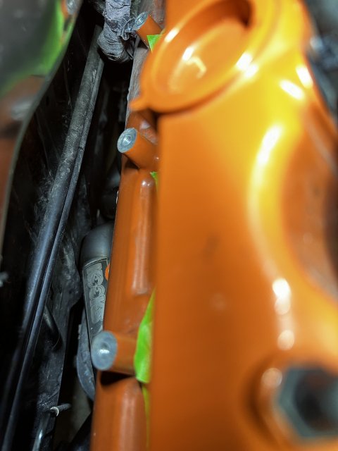

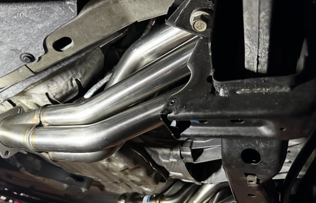

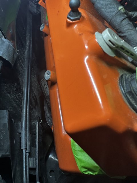

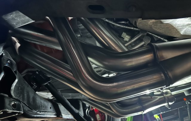

Ok, looks like I might be running into an issue. Still need to torque and crush the gasket, but I’m still not sure that’s going to give me enough room. Is anyone running the 2” primary kooks long tube headers on their challenger hellcat? How much room do you have on the passenger side? 1 pipe is just hitting the ribs on the shock tower on the passenger side. After I crush the gasket I “should” have room, but just a hair. Anyone that could take/post some pics I’d really appreciate it
