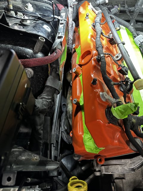

Thread Starter #80
IMG_9441.jpeg This is the space you’re working with after moving that wire harness bundle. Still not enough room to fit a regular size hand down there. No way to get from top on passenger without moving it. Working on last bolt now, much easier than the 2nd bolt from the front up top
