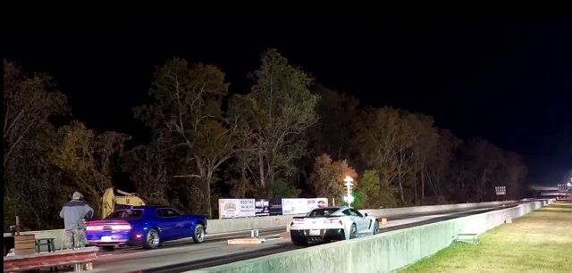

Finally made it back to the track last week, video link is below. Density altitude on the first pass was 2600' and a little less by the 2nd pass but still over 2000'. Interesting as we were discussing the "torque reserve" in the last few posts above... you can hear on my 2nd pass as I'm stalling up that it goes into torque reserve, but I gave it more throttle and it went away just before my launch.
Love the video.
Cool to watch you launching it, left that Mustang in the dust! SEE YA!!!
Bummer you only get to run 1/8 miles as the top half of the track is a fun ride :)

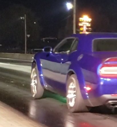

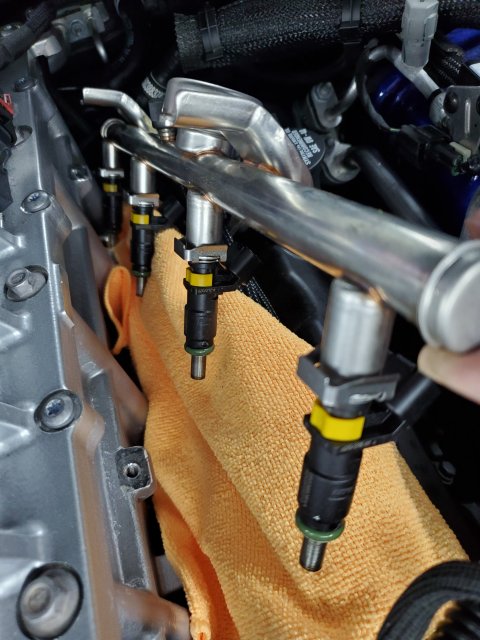

Decided to install some ID1300 injectors and try out some E85 fuel for the last track day of the season! Still working on the the tune, so this pass was without any additional timing added (yet). Unfortunately, after this first pass, the track prep went away and I blew the tires off on my last 2 runs. Will have to continue getting it dialed in next year I guess. Btw, this run was against my friend's stock C7 Z06 (on a drag radial) and I wish I had turned my camera to be looking out the passenger window... too much going on and I forgot!!

VERY NICE ! --------------- That converts to a solid 9.95-10.0 1/4 mile ET.
You could be looking at a 9.75 - 9.85 if in negative DA ?
Very impressive for just simply swapping out the tires and injectors and using E85 pump gas. (y)

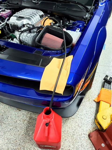

And a few shots of the preliminary work then hitting the track... 20221104_201721_2.jpg 20221025_220117_2.jpg 20221024_174633.jpg 94821b.jpg jeff vs shep launch c.jpg
