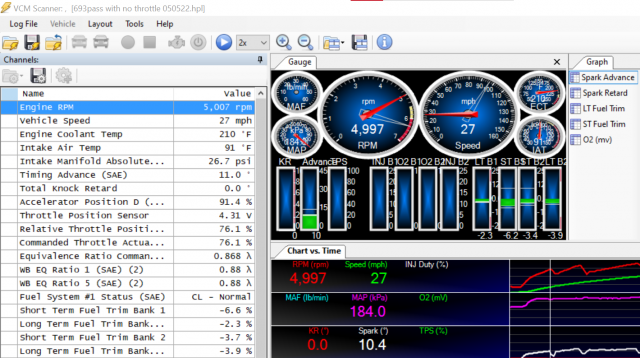

Check this out... here are a couple logs... one from one of my better passes and another from a crappy pass. Regardless, the shifts are always anywhere from 49xx to 52xx rpm's. It's ridiculous.

Would it be worth it to manually shift the car just to see how it effects the times? Agree those shift RPMs aren’t even close to where they should be.

Find the pid that says throttle position SAE and log that. Let's make sure the throttle is actually staying open.
