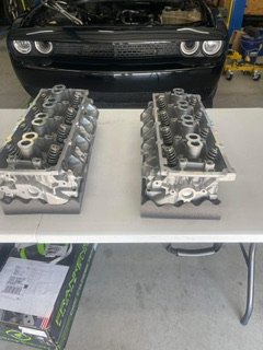

Mechanic states they are very pretty!

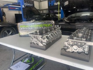

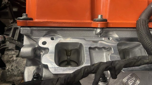

Frankenstein stage two fully assembled with slightly larger intake valves. Once together it will get dyno tuned remotely on my mechanics dyno.
Make sure you let us know what the gains were!!
