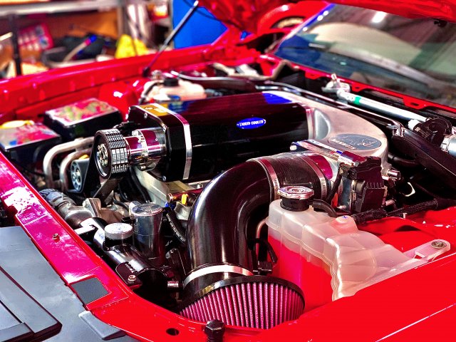

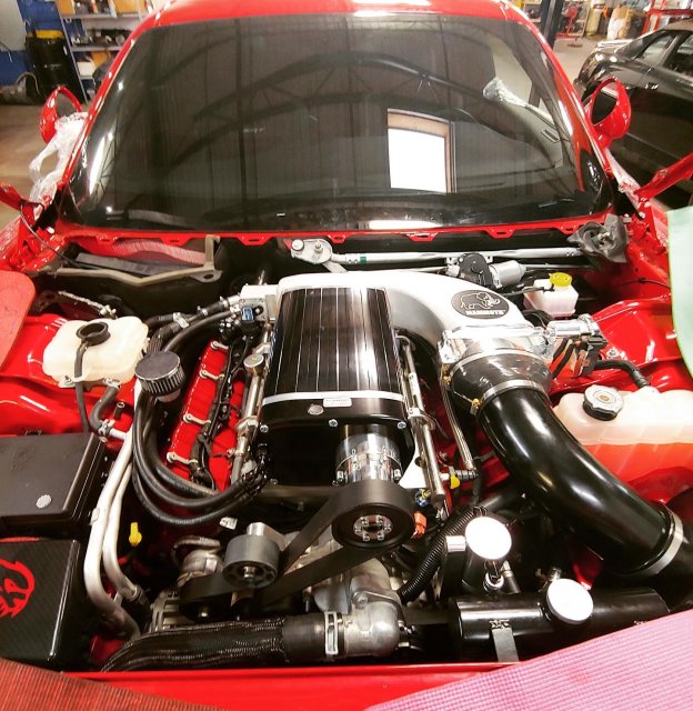

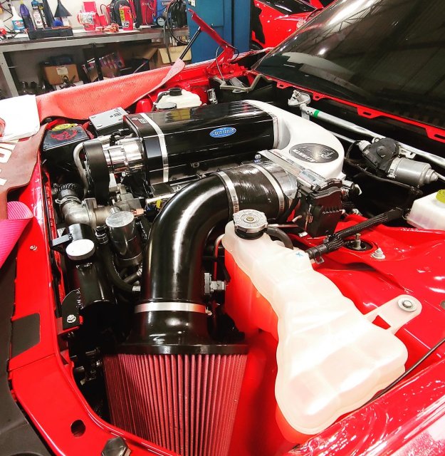

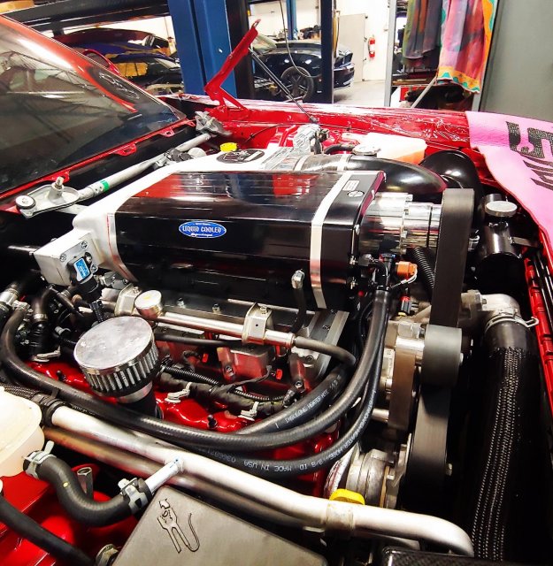

Thanks Linda! It’s been a long season not being able to drive my car though (May 5th was the last time). However, I’m excited for the future and I’ll take it in strides and see how it holds up and upgrade the rear and trans as necessary. Right now I just want to get it back and put some miles on before the snow flies! *finger crossed*
Primetime- we had a few delays waiting on some parts, a screw up from a vendor and then having to wait some more. Then Curt was on vacation so I had to be patient getting my initial tune. I should have pre-planned that better so my bad!
BUT. It got fired today and all sounded well! Need to take care of an idle issue and hopefully we can get tuning with Curt next week!
Here was the last pics I had when it wasn’t quite all put back together:
93078733-8119-465F-94D9-3402859F70F0.jpeg 52C4B821-AD27-4FC2-8333-33F3EA5C9D88.jpeg CBD5D2DF-94DF-4EBB-A408-5E518B7274B4.jpeg
View attachment 4742 View attachment 4743 View attachment 4744
Not as pretty as a Whipple but no doubt its going to perform just as well.
I completely agree! The Whipple’s are certainly prettier but the KB is growing on me. And I have a number of underhood dress-up ideas to make things a little more cohesive, yet simple and tasteful.

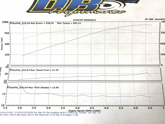

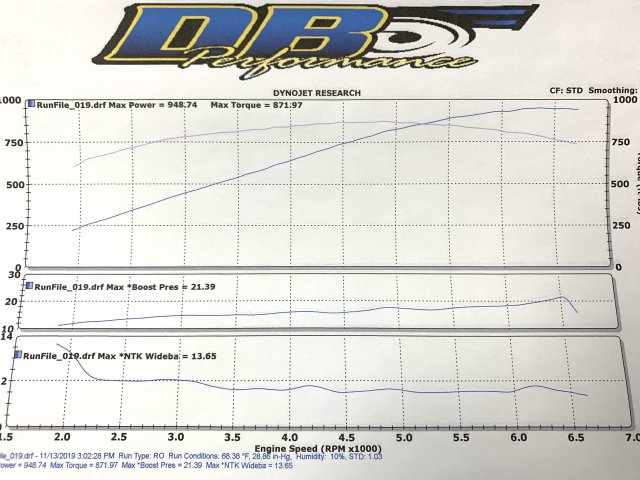

It’s been a long 6 months but my car is finally home! Unfortunately, the driving and testing season is long gone but I’m happy with the base results. To start out, we’re going conservative using 15* of timing on pump E75 using a 4” (21psi) pulley. Nothing record breaking but we’ll start here for spring time and ramp it up as needed. I still have some plans so stay tuned for more!
Here are both STD and SAE dyno sheets and short little video:

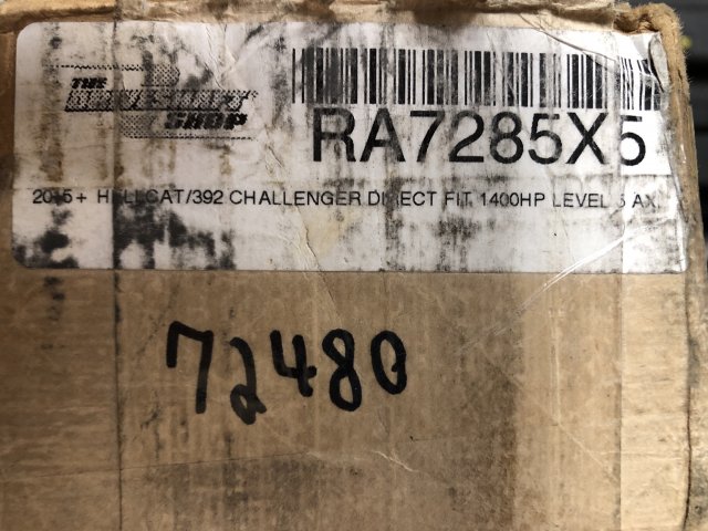

Unfortunately I already have a set of 1400 HP DSS half shafts NIB, was wondering if I needed to install them or not, sounds like would be a good move BEFORE I break one aye?
Absolutely use them, no fun breaking
3,686
8,690
Yea, it would SUCK to tear up the car breaking one especially with new ones collecting dust. Looks pretty easy to swap them out?

#57
Just make sure you install them on the correct sides, I installed them then noticed I had them reversed, tiny stickers on them, not a huge deal but still annoying.
Also make sure you put on the tone rings from the stock axels
Yep, I find it easier to drop the center section but others replace from the ends.
