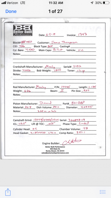

This is my build sheet. Shift point is at 6400 rpm I believe. Tim Barth is the tuner.

My engine builder Alex at BBP was surprised to see those numbers in that heat index on a stock blower.
