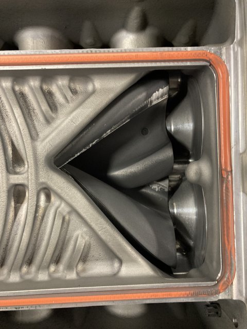

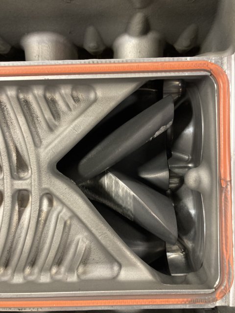

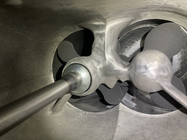

Yes. We only use the +10 balancers.
My last Gen 6 3.8 lasted less then 100 miles, 3-4 street pulls and 3 4th gear dyno pulls and the rotors ate each other and the housing this time too!!
+10 ATI lower and 3.50 Satera CLUTCHED UPPER PULLEY and it still failed!! Dusted my engine so bad with aluminum dust the oil sample analysis drawn with oil the that only had 100 miles on it as well picked up the aluminum in the oil!!

Id have burnt HQ to the ground after that.

That’s when I threw in the towel with Whipple, I sold the warranty replacement while it was still new in the box.

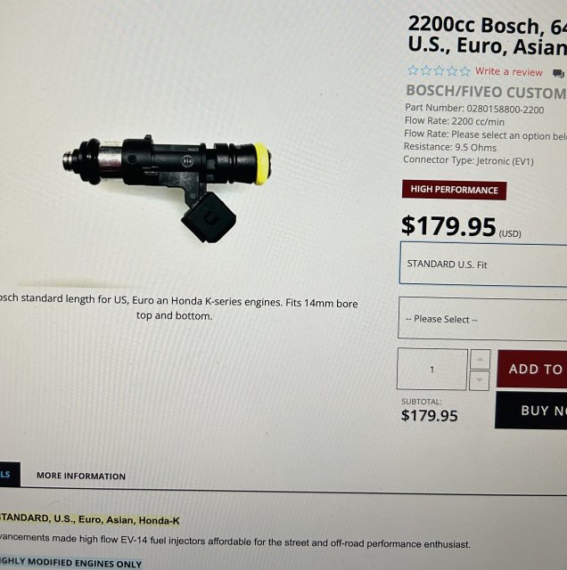

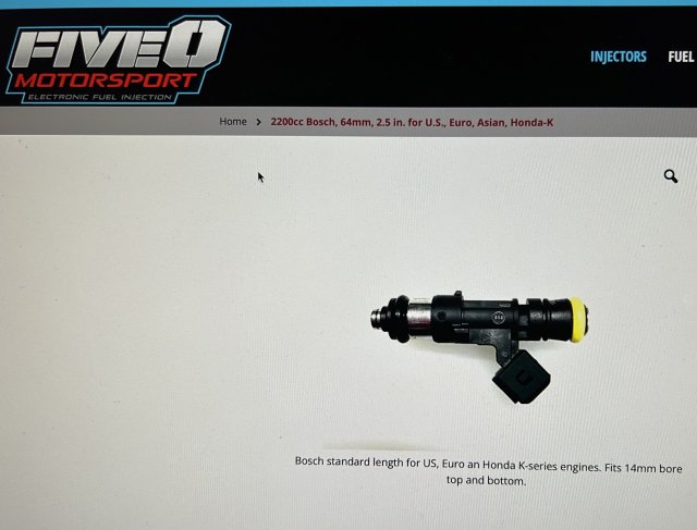

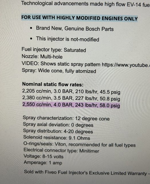

I'm beginning to wonder myself if I would rather pay for the fuel system or the cost of fuel. Either way they have you by the balls.
The injectors alone are more than double what my dual pump system cost originally. Oof.

Will need at least 2150's, triple pumps, and 2 baps.
