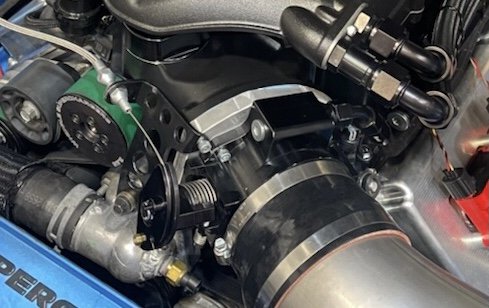

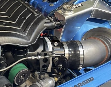

No Tb no fuel fittings no air intake system
Need to buy adapter to for tb. And fittings

We fabricated all that. C19E263E-ADA1-4C17-96E3-65BC21698F53.jpeg 239129CE-6F77-4CA4-85DF-5BE608913C38.jpeg
