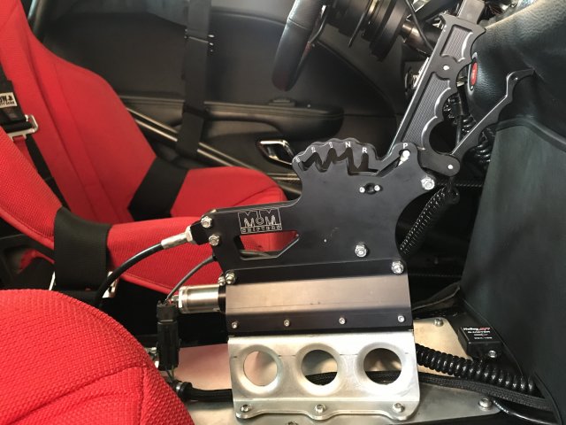

There was one error on my part as a driver that might have saved me from bending rods to the point of seizing up the motor. My TH400 has a safe neutral which I can click into from 3rd gear and I’m supposed to do that as I let off the gas after deploying my parachute. Instead of being high rpm and straining the motor with engine braking, being in neutral would have quickly brought rpm’s down with no load on the motor and I think would have limited the severity of the damage. Unfortunately, I barely spent any time coaching myself on how to operate everything that was new about my car. I didn’t spend any time building muscle memory with practice dry runs sitting in the car either. Most of my spare time was spent on trying to prepare the car to make race events over and over. I should have spent more time on getting myself familiar with the TH400 setup versus jumping in and getting after it right away.

Its been years but i thought you were not supposed to go into neutral in a 400, can overspin the trans and turn that into a grenade.
Again, its been years and I'm sure someone possibly came up with a solution by now. I'd double check with your trans guy.
