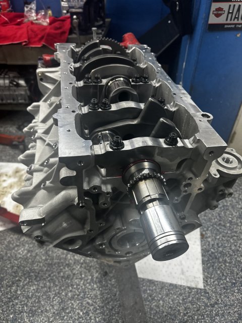

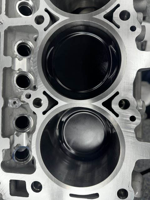

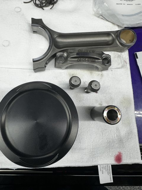

crank is in .002 main bearing clearance. Bolts tq to 80 foot pounds. Cross bolts to 25 rings are filed to .029.
this is fitted with a Winburg crank.

That's a nice looking pile of parts. (y)
4,385
10,911
Wait a minute here that doesn't look like a stock 6.2 :unsure:
8,777
7,700
It’s Al-lu-mini-um

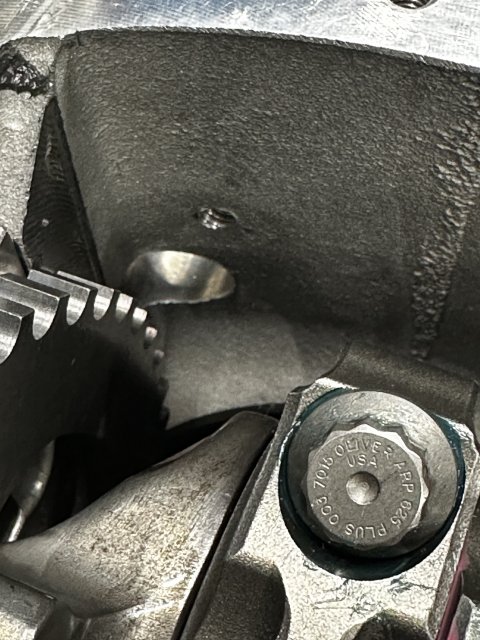

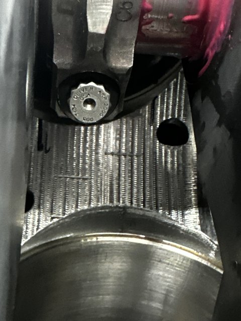

Christmas Morning time to do my shit.💩. Got my short block done not fun having to grind on a 7500 dollar block so rods clear cam tunnel. But it’s done
What does that wheelie woo down there drive?

The gear at the end of the crank?
That’s your reluctor wheel for crank sensor
Thanks. Does the sensor screw in through the block?

Looking good! Did you have to grind the bottom of the bores for the rods??

That’s crazy! Didnt have to take anything out of the sleeves though?
Nope.
It's not uncommon with custom bore and stroke combos or camshafts with cylinder heads.
