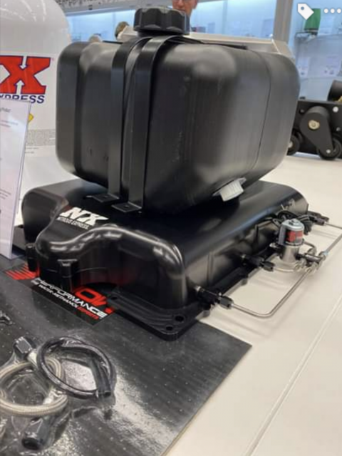

Just saw this on the faceballs - nifty!
Meth and nawz!
