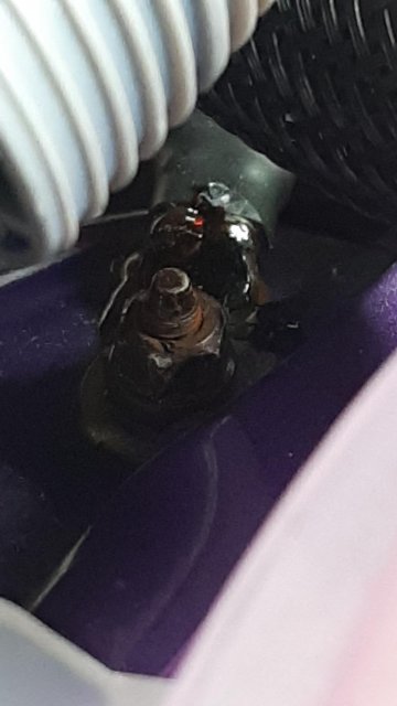

Update:
The culprit. The ground on the back side of the strut tower that runs to the bellhousing. I thought it would be loose at the bell but was visibly loose here. All other TIPM grounds were tight except this one...and it was the cause of the entire issue.
Bonus though. I can now change a starter in 15min practically. So yay for me. Long tubes also make that easier believe it or not.

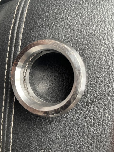

Whenever that particular ground to the bell housing isn't secure, the trans may try to ground itself through the converter galling the pilot bushing that the converter slides into. Often when this happens, the converter will stay stuck to the engine when puling the trans off. I've had to replace a few pilot bushings and smooth out the converter end a couple times because of this.

Jesus, how many amps are pulling through there to weld the bushing?
I dunno, but here’s what it looks like when you forget to secure that one ground to the bell housing. No apparent issues besides being surprised, disappointed, and a oiley mess whenever pulling the trans and the converter stays on the crank. IMG_4664.jpeg

This picture is a bit too close to understand where this is, can you post a picture from a bit further out?

#79
Perhaps tomorrow once the sun comes up.
It's pretty much directly between the strut tower brace and the PCM on the back side of the passenger side strut tower. A wiring connector is above it attached to the bar itself. There are 2 wires that attach to this point. I partially removed the wiper cowl and went in thru the supercharger coolant hoses with a flex head 10mm wrench. Socket, extension and universals would also work.
