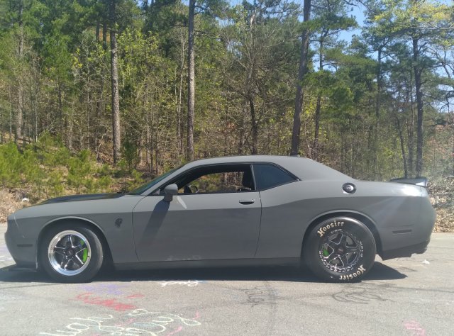

I've used 305 45 18 MT R's, 315 50 17 MT R's and finally the DBR in a 29.5x10.5x17. Wish I would have found them sooner... all my experience is on the street but I like them A LOT better. Even in the cold, with no burnout they hook on the street like crazy. If they hook this good on the street, i would assume they'd hook even better on the strip.

damn they look good too!!! Now that fills up the wheel well

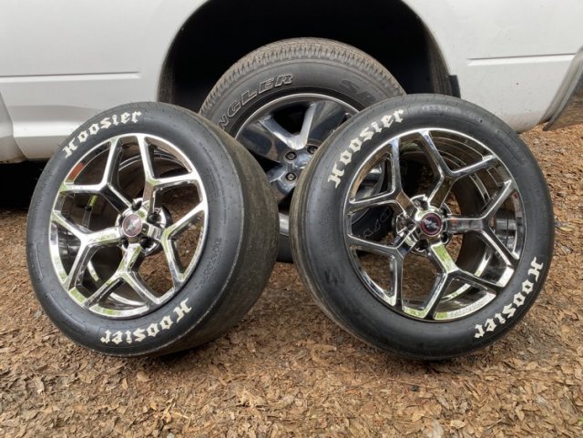

I bought them and tried them this past weekend I got 28/10.5/18" and to be honest I started out with 18psi and lowered until I got them at 12psi and my car would never hook up with them. The best 60' I could get was 1.60 which back to the street r's and the first run was 1.46 60'

I ended up making 4 runs and which back out to the street r's.....now I dont know whether to keep the Hoosier's or not

The swap to Pro Radials. Not Hoosier. Those sidewalls are way too small bro.

look into getting a 17 inch wheel out back and getting a little more sidewall under it. The Hoosiers are only marginally better at low prep situations, on prep they aren't great at all. The MT will be much better when there is prep down.

yep I was worried about the sidewalls after I got the tires and yes to small
