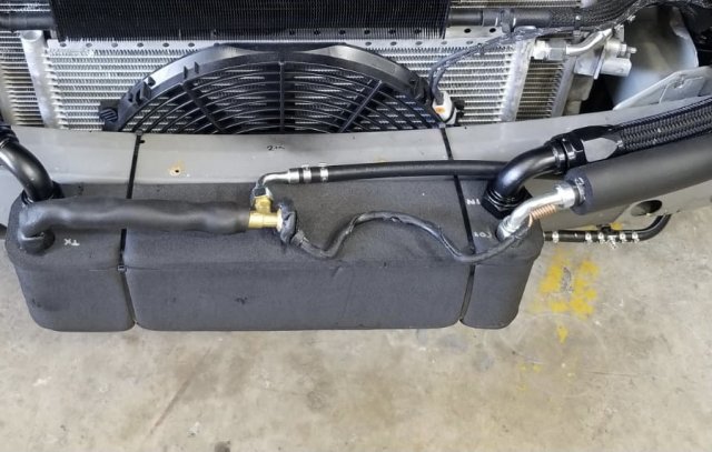

AKA.. The Dead Sea Scrolls 😂. That was back when we were facing off with 185 mph pulls on the Gila Bend Half Mile and trying to keep those 4.5’s cool. 615868CC-3967-4B70-BE87-C142075BA5D1.jpeg

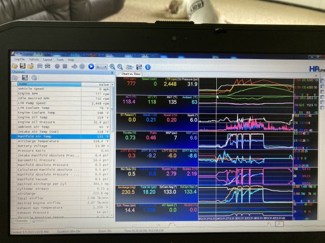

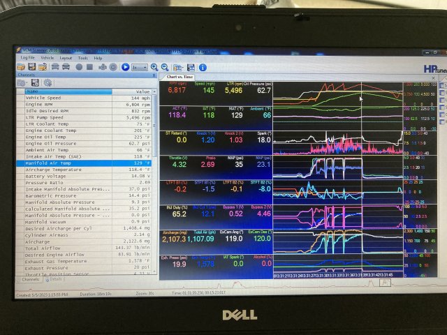

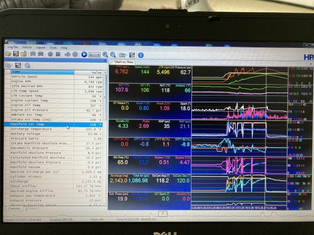

Here’s the 3.0 back to back 1/4 runs last month
D43C24B1-E6AC-414E-B5C9-BF5EA584D656.jpeg BBD6286F-9206-47EC-9BDF-7DD3BA06EBDA.jpeg 829D9768-C267-4A76-B377-2ACCA3FBBCBF.jpeg 77578986-9199-450B-8659-C5D5F73119B5.jpeg

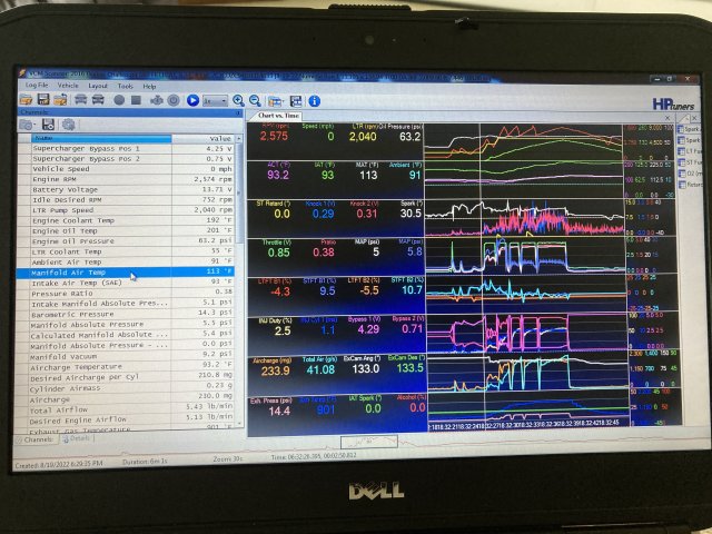

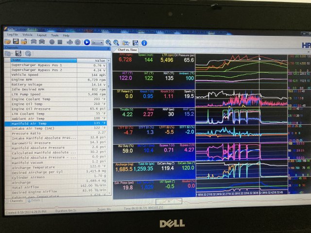

Here’s the 2.4 2.72/+10 combo, yea, it got IAT timing pull hot by the end of the 1/4 but it was 90 F ambient that day
1F8F87B8-6EA5-46F4-9F4A-711F9DDB771E.jpeg AB79EA4B-29F7-4EC5-8D89-0399D709F15E.jpeg
I only run E80-85, no more 93 for me so the Whipple fits the bill but Whipples start rattling wayyyy too often.

Big problem with traction on that old sand covered runway. Most of the Hellcats couldn’t make it to the finish line without a a ice box or chiller before it shut down due to IAT. Good luck. It is fun!
