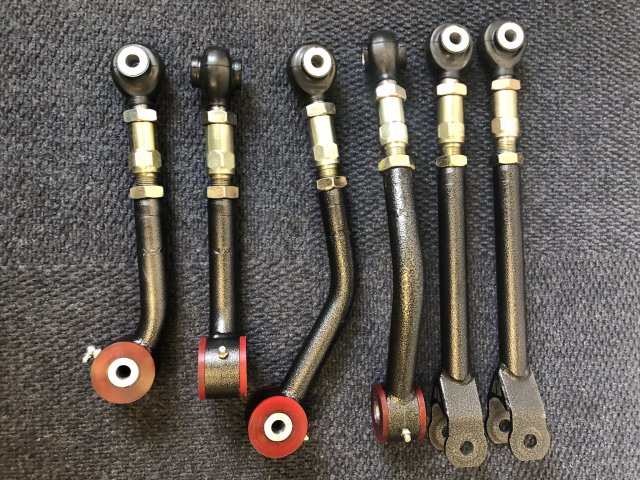

Not so much harsh, BUT they make noise. The Energy Suspension bushing (red) grease fed has failed me on their toe arm. No problem, the AAD Toe arms are about to replace the BMR units, then I’ll have AAD adjustable in all the right places in the rear and their one arm up front also. Great products!

I just ordered the BMR cradle lockout kit, BMR safety loop, ADD drag pack suspension package. Plus I have Demon springs already here in my office waiting to be installed. Oh ya and I have AFE race exhaust in the box also. Hopping for 1.40 60s with this setup.

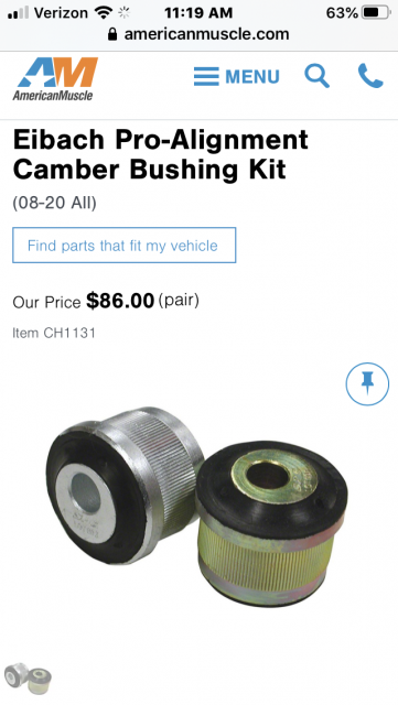

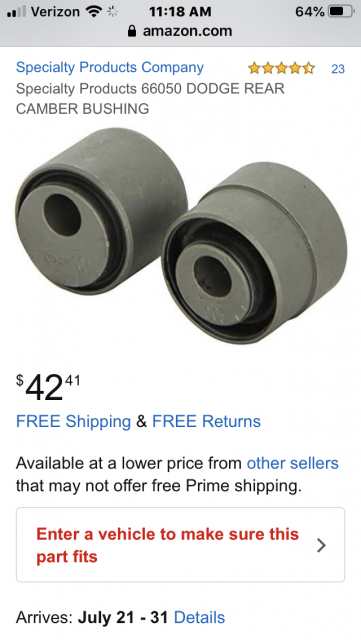

You can use moog K100173 on the rear upper forward arm to get plus or minus 1.5 degrees camber with the stock arms.
I made a suggestion of using these on another post on one of the sites but no one chimed in on if they work or not. They where a different brand though but same concept.
Do I need 2 or 4 of these, am I replacing the bushing at the outer end of the arm or both ends of arm on each side of car ?
11,025
They come 2 in a box . So you will need 2 boxes

Technically you only need to replace the outside bushings in the arms( next to the knuckle) that it's self will get you up to 1.5 degrees +/- . So 1 box will do 1 side of the car .
5,202
9,661
So the 2 part bushing kit is on 1 end (outer end) of arm ?
11,025
Correct . You get 2 bushing in the box . 1 goes on the aluminum upper control arm on the out side . The other bushing goes on the stamped steel upper control arm on the out side .
1 box does 1 side of the car .
