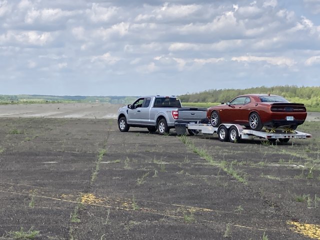

Last month I trailered the RE up, S2, fully purged and primed on 100 octane, it was all dialed in ready to run. I brought extra 100, generator, fan, battery charger, alternate wheels/tires, jack, tools, etc... It was a serious attempt, and successful beyond my hopes.
Next week I'm driving the mostly stock M6 up, much more pleasant to drive than the truck and trailer, don't need all the crap, not looking to break any records, just fun! Space is tight but manageable, thanks to the huge trunk! Much more fun to drive up in the HC, but the truck&trailer allows lots of space for everything you think you might need!
