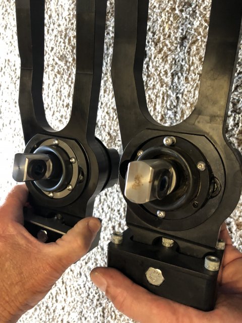

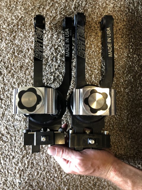

Was gonna start a new thread, but there is nothing to compare. They feel almost identical on my only road test so far. If anything the third rev might feel a tad better than the original. So I’m going to sell my old one on here soon for a good price. You can see where a few of those tiny Allen heads backed out of the bottom. Had fun time installing if nothing else

View attachment 21601 View attachment 21602 View attachment 21604
