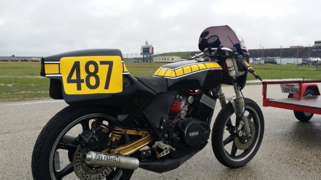

I worried about warranty when I had one. I'm still stock, but I have no intentions of racing my HC, I have motorcycles for road racing, I only race on closed courses and am bored by drag racing. I used to drag race but became bored by it. Can't take waiting for hours to experience 20 seconds of excitement. Hence my switch to road racing. Really enjoy endurance racing as long as it's a road course. I have no time for ovals. 20150321_093335.jpg

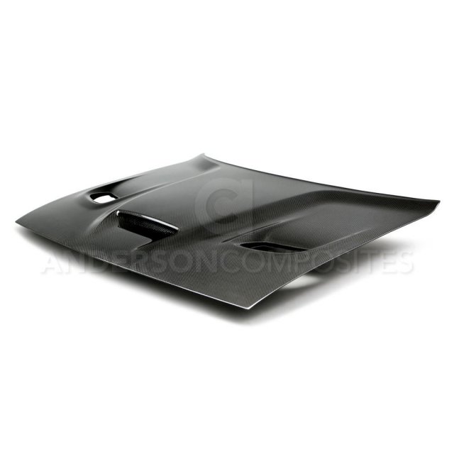

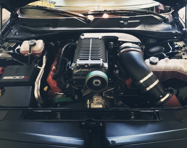

Some of us are trying :LOL: Next season i'll have more to share. While the car is down for winter storage i'll be swapping the hood to Andersons Carbon Fiber. Was considering the Kenne Bell cowl style hood but looks like the 2021 Drag pak is sticking with the older style. I'm guessing it's more aerodynamic. Planning to go 200+mph so don't want additional drag.

The cowl hood has less drag. If you look at it from the side you can see how it reduces the angle and frontal area of the windshield. In other words.... the increased slope of hood makes it integrate with the angle of the windshield better. Kenne Bell says it reduces the “umbrella effect” over the stock hood. Especially the Demon hood. The other thing it does is heat extraction. The air in the front goes directly over the top of the engine and out the back of the hood. And..... it gives you the room to lift that Whipple with the plenum spacers made by Gearhead without spacing the cradle. That is worth a hundred horsepower with zero downside.

The cowl hood looks like it would create more drag at higher speeds to me still, can't know without testing. I do agree they vent heat much better than OEM. Would be ideal to see wind tunnel data to back Kenne Bells claims. Drag pak is doing 7.5 with the older style SRT hood. Always room for improvement in this industry though. Think i'm going to stick with the OEM style for sleeper factor - TX2k's Heavyweight class doesn't allow modified hoods either. "-Super charger must fit under factory style hood no cut hoods for fitment" :censored:
Kenne Bell Cowl Fiberglass hood - $899.00 + $220.00 shipping - $1119 total
  • Increases HP Via Lower Restriction, Cooler Temps and Reduced “Underhood Umbrella Effect.”
  • Vents and Reduces Underhood Pressure and Front End Lift.
  • Vents and Lowers Underhood Temperature.
  • Eliminates Stock Hood Air Flow Restriction.
