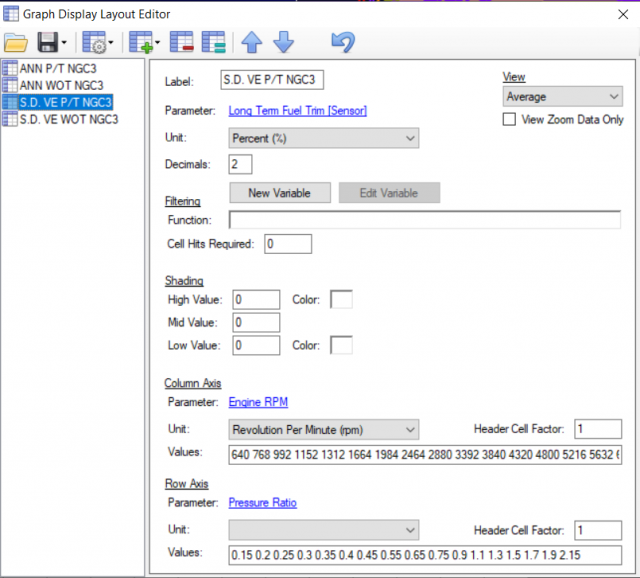

Then I setup my histograms in VCM Scanner as per the instructions in some of the courses as I have taken and this is where things have gotten a little wonky. The Graphs they supply need the following channels logged: Engine RPM (pick your flavor), Pressure Ratio, LTFT Bank 1 and 2 (SAE), STFT Bank 1 and 2 (SAE). Then the graph they provide has the following configuration after I copied the PRatio and RPM labels from the VE Bank 1 table (44273).

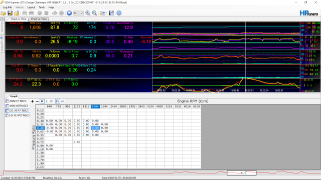

Then I went for a quick drive around the block but as you can see the graph wasn't populating at all with data.
So I noticed that STFT were way off the reservation and so then I changed my histograms for the logging to be use the LTFT+STFT for part throttle and I started to get a lot more data populated.
However I can't tell what is the proper way to setup of the histogram. If anyone would like to contribute to this thread please do so. I plan on this being an open source knowledge share so individuals that want to switch to using the VE tables and tune using community knowledge won't be afraid to do so. Also I went to HP Tuners site and looked in the Mopar section and could not find a good example of how individuals were logging this data to make corrections. They have a great Inj. PW vs Fuel Mass article but nothing regarding this topic. Even checked @Speedy! old youtube vidya's but couldn't find anything either. For all the protections that I disabled, it is important that when you have finished your tuning cycle to return all those values back, I saved mine in an excel spread sheet. It is also important to understand that you do not go above 50% throttle or 4000 RPM when doing part throttle tuning.

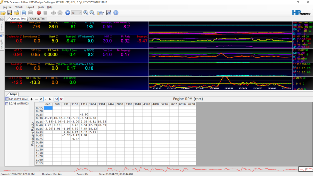

Setting it up the way he did it and looking at the historical data I can see I got my work cut out for me. So as an addendum to anyone that bought the Tuning School books and are wondering why Long Term Fuel Trim (sensor) might not give you all the data it was suggested you have to drive the vehicle for a very long time to accumulate data. Considering this car is now a grocery getter and track slut the following configuration is way better:
I will keep a running log of the weeks data and share in this thread. I'm happy I can start seeing the data I need. Stay tuned.

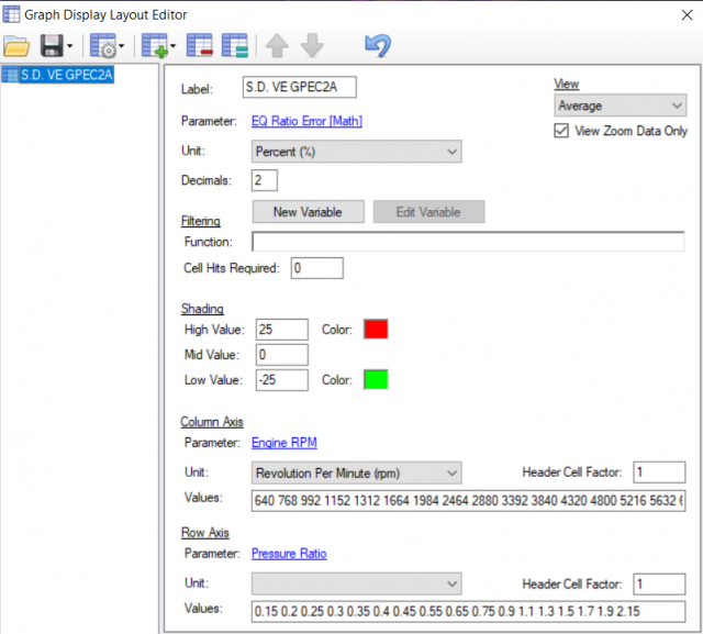

Hold the presses, Math makes more sense drunk. So I was thinking about this and I got it all wrong. In some other training I have taken what if we can short circuit the Speed Density principle. i.e. just calculate the difference in actual eq ratio vs eq ratio commanded. Okay so HP Tuners and the Tuning school books already do this but they use some janky terminology. Lets take some data from a point in time for a lean condition.
wb1: 1.11
wb2: 1.07
commanded eq ratio: 1 (when it would never be this is my guess)
wb average: 1.11 + 1.07 = 2.18/2 = 1.09
so to find the percentage that I am off lets do some more maths (keep pemdas in your head)
100 * (1.09 - 1) / 1
100 * (.09) / 1 = 9/1 = 9
This means we are off of our target by 9%. Now that I have reversed the math I will be setting up the Histogram as follows and loggin EQ Err.
This makes so much more sense in my head as for the given air mass in grams I am not inserting enough fuel into the system (negative means rich, positive means lean).
