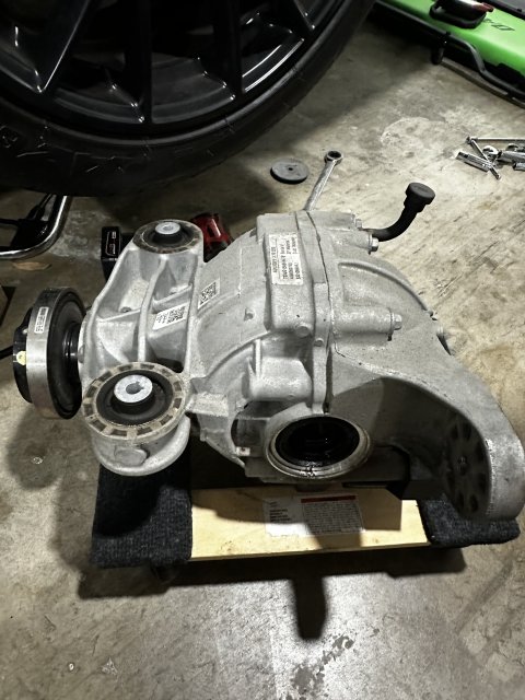

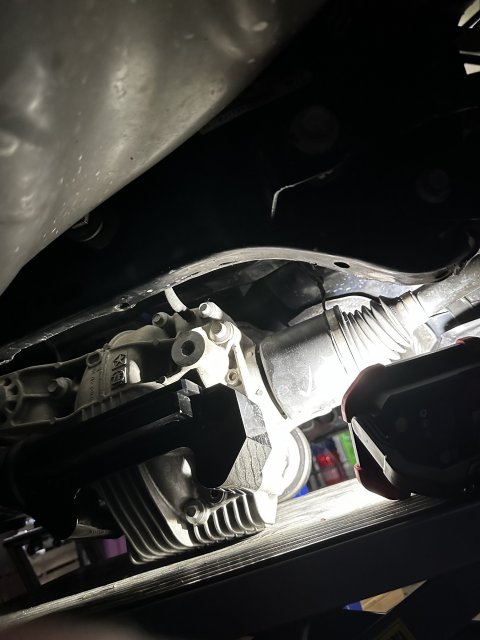

You don’t need to drop the cradle to replace the diff, I literally just did it a few hours ago lol
8,512
7,439
I’ll do it all for you bring it by
8,512
7,439
