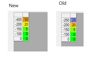

Cutoff, DFCO -> Misc Cutoff -> Torque Reduction
This one has me scratching my head...

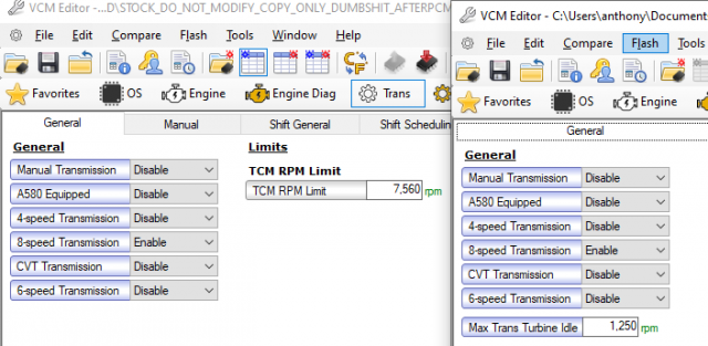

Transmission -> General
New to me: [TCM] 5722 - TCM Limp RPM Limit: If the engine RPM exceeds this TCM RPM Limit, Limp mode will activate and a DTC may set.
New is on the left, old is on the right, one option is missing, and a new one has appeared...

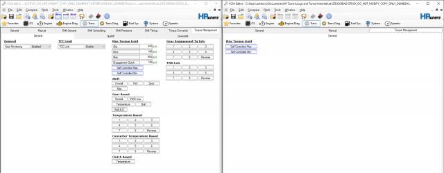

Transmission -> Torque Converter
All new in the comparison, may be a bug. If you would like these values if they are indeed new, please let me know and I can post them.

So there were quite a few changes in the new update, mostly around throttle body and torque management. I have nothing to say about the Transmission tables that are new to me because that might be a bug with the 4.4 software when I did a stock read of the PCM. Who knows what is really going on. Figured I would bring this out into the open for others to comment on, please let me know your thoughts or if there is any other data you would like to see. In other news my VCM Scanner is working as expected and I can see all my Channels again in the Beta.
