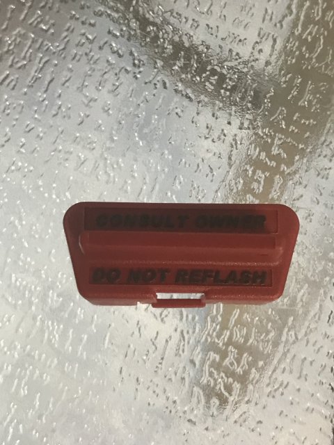

Bob, folks are getting their tuned PCMs over-written at the dealer?
4,849
25,751
Thread Starter #51
Never ever let them flash your tuned PCM. I even fire a warning shot.
