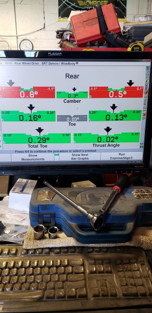

You are dead right on the contact patch, have a full set of BMR on car adjustable arms to take care of just that and these Demon alignment specs which should put the tire dead flat on launch, that’s the hope at least. I’ve read most all hellcats contact patch looks like this and will make tires that see just hard launch and 1/4 pulls often, and that what these tires say.
Yea, they are all folded up because I put them back on one last time for line lock testing, that finished them
off!! These specs are minus driver, with 200lb driver they match side to side. When squated this should make them flat and square to the road.
Yea, they are all folded up because I put them back on one last time for line lock testing, that finished them off!! View attachment 15579
Oh yeah. Get that done ASAP. It will change the entire way the car feels under WOT. You will literally feel the ass of the car planted under acceleration solid. Then you just control the nose and keep it pointed straight.
WOW, that good aye?? You just gave me the motivation to get cracking on getting them installed!! THANKS!!
So these alignment targets look good by you??

Too much negative camber wears the inside of the tires first
No, this is coming from off the line wear due to uneven weight distribution on the tires due to how they orient when under acceleration. The guy thread I screen shotted these specs from I believe knew what he was talking about. Another high HP whipple or KB guy, the guys on this forum I think as well. I’d have to search back through threads if posted to find him but if might have been Mark??

VERY good thread. Thanks for all the real world and practical application reviews. Makes it easier for a first time drag radial buyer to make a decision. @WhipCat . You have rear caster/camber settings you prefer for street/strip combo? Thanks in advance.
I don’t have any caster camber settings saved to share.
the fixed arms I originally had, automatically made the correction.
But I also have mopar springs which give me a slight overall lowering of the car. This makes the control arms very necessary.
my settings could be different on your cars.
I have since gone to an adjustable setup because I have a new drag wheel setup i switched to and need to make changes between street and strip.
