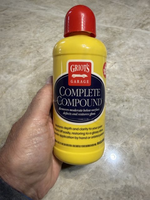

Simple and the accepted proper way. I do not know shit about anything called “magic”. Forget-about-it.
Clay it. That WILL remove the water spots. Then you need to treat it and protect it.
After the clay use this.
Then it does not matter but at your choice then apply a wax or protection layer of your choice. Regular, ceramic, whatever but get a coat of protection on it.
Whatever you do to the water at home quit using whatever spotted it. That can be minimized by wiping the car off quickly and completely after a wash, period, no exceptions to that rule no matter what water you use.
