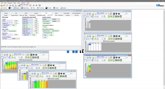

Some interesting results from today's parking lot tests. I started out by doing a diff of the 2018 Hellcat A8 file and applying all column and row axis values to the following launch control tables:
[ECM] 47501 - Launch Control Torque Reserve (Slow Path)
[ECM] 9962 - Launch Control Fast Path Proportional Term
[ECM] 9959 - Launch Control Slow Path Minimum Error To Enable
[ECM] 9960 - Launch Control Slow Path Initial Torque Reduction
[ECM] 9961 - Launch Control Slow Path Initial Torque Reduction Multiplier
[ECM] 9957 - Launch Control Slow Path Proportional Term Multiplier
[ECM] 9958 - Launch Control Slow Path Integral Term
I wrote the tune and then drove to the local school parking lot, just my luck a little league game was going on... fak!
So I pull into the lot on the other side of the field far away from people.
Left it at 2000 RPM for the first test, made a whopping 6PSI of boost... Started to spin. Also got scared shit less cause of the way the wide bands sensors were knocking around. Here is a screenshot:
I undid the work. Although I didn't spin in 1500 or 1750 rpms I realized that the row and column axis modifications might not be worth it for me they were also wildly off. So I decided to go a different route. Currently heading back to the spot, having a moment of genius.

Do you happen to have a stock read. I updated my HPT to 4.8 but the 2018 Hellcat A8 calibration might be stale. So I kinda fucked up. I had a good setup here.
Just went back and did more testing. Not a fan of this, I'm willing to leave launch control the way it is. Something I did notice is that the Demon Stock tune is more lined up with my 2015 Hellcat Stock tune... Wonder what that means. Scrapping all the tunes as Indont know what looks safe. Do you have any logs when you are on LC?
