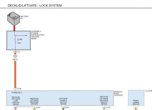

It appears from above diagram that the tan/yellow P31 wire is the actual latch driver...have someone push the release while you check for full voltage there, should tell one of 2 things, wiring issue before latch or, if full voltage is present when requested, latch is bad. BTW, if memory serves me correctly the earlier models had a lever on the side of latch that was the equivalent of child lockout...not sure if newer ones have them or not.

Yeah it’s good
No voltage but wire has continuity

As stated above, press the trunk release button, check for voltage, at the latch connector. Should be 12v.
Also, check the relay.
Since BCM wire is good, and FOBIK doesn't work, may be relay, or bad ground.

I'm not seeing a relay in the diagram. Am I missing it?

My book mentioned a relay, in the BCM diagram, but I couldn't find it. Maybe more data in the owner manual?

looking it’ll at it. I should test from the fuse to the bcm since it is a different wire

It 100% should have 12+Volts when actuated, a 2nd person hitting the button while you observe Voltmeter will tell, you could even use a 12v light and put one side to the wire and ground other side..then you can just hit button and see if it lights.

That was the first test I did and nothing.
