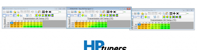

Here is my 1 to 2 shift fill time stock. All I did was -10 from the lower rpm ranges. from 86 deg over. Sounds like we had a similar thought process here.
But this shows why it is important to get your trans temp up before making a pass.

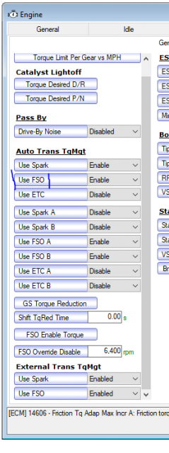

@fumanchu182 Have you been playing with slip times at all? I have also made some adjustments to that table.
Also I find it a bit crazy for TQM with these trans to cut power for shifts. Seems pretty crazy cutting fuel on a boosted vehicle. I have read on the hp tuners forum some say this is safe and needed for big hp vehicles. Well I had someone send me a datalog a few weeks ago of a car someone else tuned and well it cut fuel and it blew through the shift and it kept cutting fuel hoping it would shift. It was for about a second but at 6700 rpms and fuel cuts out for a second well no good. I was surprised the car lived through it.
For anyone reading this I just leave use spark on. This is a factory tune leaving FSO on
same here i disabled all but “Use Spark”, the theory is that the rest are too intrusive. Hell for ETC to even activate you’d have to be almost close to nuking the car temp wise, by then other safeties will already be activated.
6,915
17,838
Yeah pulling fuel at shift is bad IMO. I turned that off after I saw a lean condition at shift and couldn't figure out why. The injectors were shutting off. I don't know why they did that on stock vehicles, seems very bad to me.
Same here I disable all fuel cut offs . That's nuts on a boosted engine . I tried using the throttle blade closing with the spark but it was too dramatic sometimes .. so I disabled that too and only use spark now .

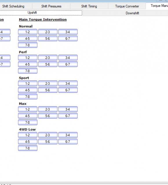

Here are the tables to play with how much power you want torque management to kick in
11,025
I'm trying to think of some other tops we can talk about here. Not much info out there on these trans and learning them takes a lot of time of trying to fiddle your way through things.
Pressures are pretty simple. Like a hard shift add pressure. Don't want a hard shift take pressure away :) Having a shift flare maybe try some more pressure.
@Hpindy I am wondering if the throttle blade opening and closing is a slower process than taking spark and fuel away. Maybe that's why from the factory they chose not to use it and pull fuel instead. I would think spark alone though could have accomplished what they wanted.
Some times it would close the throttle blade so hard I almost hit the steering wheel. It was pretty sudden.. if it was gradual it might have worked better.
I have only messed with the Nominal Slip. And yes tables 47106 and such have been modified. Reduced by 25% but no more.
