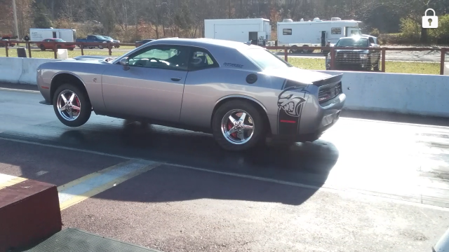

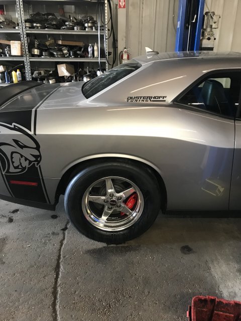

Here’s a screen shot of the car on the dyno. It’s from a video (I can’t post those here). It’s with a stock 20” wheel and tire on the rear. The fronts are 28’s also and the car sits level front and rear with the 1320 springs. I do think they lower the car a little all around though (probably due to the increased weight of the Hellcat) because they noticeably changed the camber on the front. I will also add a picture where if you look you can see that the tops of the tire are now tipped in due to this. The only way to “fix” that is by adjusting the cradle and I didn’t do that because I think it will steer better in a straight line under acceleration the way it is. View attachment 7640 View attachment 7641
Thanks for the pictures. I think so far I like the way these sit the most. One could argue that the 4x4 look the OEM demon springs give you, give you more travel room for launching, but I don't care for the lifted look! It might lower it all the way around, but I would imagine it would lower it more in the front (less weight than 1320) vs the rear we should be about the same weight. Have you tested them at the track yet? You happy with them over the stock springs? I've seen a few drag racers at the track have tow in with their fronts as well. So did you not do an alignment then? I'd want to make sure the rears are getting as much contact as possible, but from your pics they look good. Plus the 1320 springs are very reasonably priced! My Redeye should have about the same weight as your Hellcat does, and I think I'd be happy with this look.
Post your track results if you haven't already! 60fts, or anything such as more reliable launches. I would imagine the weight transfer should be pretty good. How's the around town driving? Very soft or? The only issue I see so far is clearing a trailer if its lowered more, lol. Borrowed a buddies trailer, and with my stock fronts I barely could open the door (1/4"-1/2" inch) clearance (open trailer). So I'll have to likely dukes of hazard it lol.

I did another alignment but left the camber alone because I didn’t want to mess with the cradle. I did learn something in the process though. I told them I wanted a zero toe in the front and rear. I was told that a actual zero toe setting in the front is not the factory setting. He explained that for the street, the front alignment takes into account that streets are crowned for water runoff and the factory toe alignment compensates for that. He said if I go with zero toe, it will pull to the right unless I’m on a flat surface (like a drag strip). I told them to set it up for the track. Now going down the road.... it pulls to the right. Race cars are not street cars. 😂 As far as the ride goes..... the springs are a lot softer and did improve the ride. That being said..... with what I’ve done with the suspension and bushings in the rear, the ride has been described as “like a brick” so softer springs were a improvement. There is no doubt that it transfers weight better than the stock HC springs. As of now we’ve only had it on the track one time and due to conditions only made one pass with this suspension/tire combination. There are a ton of variables but short story... it didn’t hook up at all, and yet.... still produces sixty’s in the 1.4’s. When you’re peddling it to get off the line and still running under a 1.5 sixty..... there’s hope.

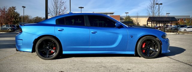

Haven’t launched my OEM ones yet. Have to wait for spring. I’m in winter mode now.

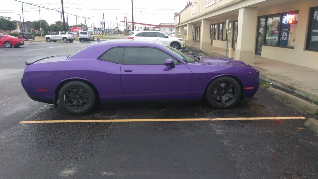

With the HHP version installed. Right after with maybe 5 days and 200 miles since the installation.
Those are with 305s in the back right? Looks like it sits about the same as stock.

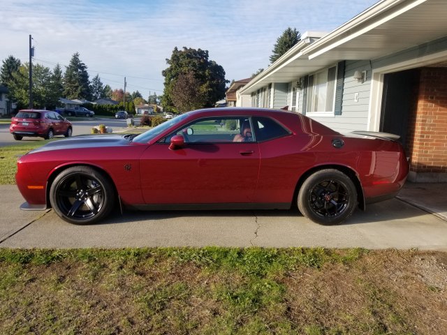

@TEXAS REDEYE
HHP Drag springs
19' Redeye OEM springs.

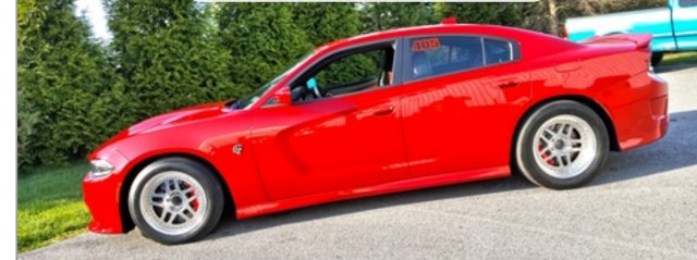

Here is my car with demon springs and about 5000 miles on them to settle .
Rear tires are 305/45/17
Fronts tires are 27.5/4.5/17
