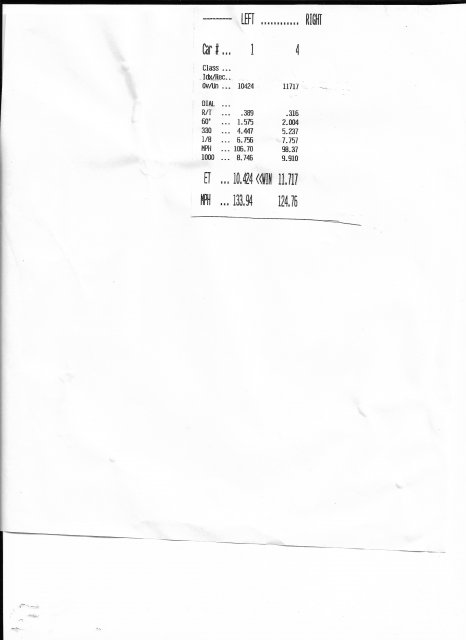

My mods are real simple, 2.85 upper, tune, 180 stat, Mickey R's 305/45/17. Work done by Peitz performance in Houston. Red Eye. No weight reduction, no skinnies, just drove to the track, lowered the tire pressure to 18 on the Mickey's then lined up to race.
My only passes were made during the Lone Star Moparfest, and there was a hiccup in the tune, so my PB that day was 10.42 @ 133, with a 60 foot time of 1.575. The DA when I made that pass was around +2,000. Needless to say I wasn't a happy camper. The hiccup with the tune made the car feel like it was starving for fuel on the upper end, but that was corrected before the end of the day. Anybody that was racing that day can vouch for how hot and miserable it was.

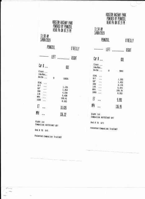

When I made my first pass today, I knew by both the butt dyno and a timeslip that this was money well spent. The DA was -325 (great for Texas) and this was a track rental, so the guys did a jam up job with the prep.
My PB until today was a 10.42. To simplify, I now own a 9 second car........well 9.991 is still in the 9's. The slip showed 9.991 @ 136 with a 60 foot time of 1.453.
I turned right around and ran a 10.026 @ 136 with a 60 foot time of 1.454.
Original PB taken at LSMF.
Passes I made today.

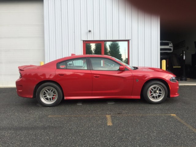

I have the HHP Drag Race Springs installed ( demon like springs)
I really like how they help the weight Transfer
Best 60 ft was a 1.37
I do not have any other suspension parts installed.

That is the day they were installed
Linda

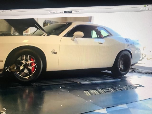

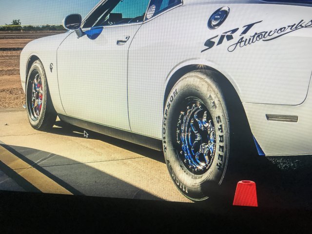

Here’s a screen shot of the car on the dyno. It’s from a video (I can’t post those here). It’s with a stock 20” wheel and tire on the rear. The fronts are 28’s also and the car sits level front and rear with the 1320 springs. I do think they lower the car a little all around though (probably due to the increased weight of the Hellcat) because they noticeably changed the camber on the front. I will also add a picture where if you look you can see that the tops of the tire are now tipped in due to this. The only way to “fix” that is by adjusting the cradle and I didn’t do that because I think it will steer better in a straight line under acceleration the way it is. D450663A-346F-4672-9F85-1AE637B8368F.jpeg DD331D87-A1A2-41E7-B8E9-3BBB77C09FDE.jpeg
