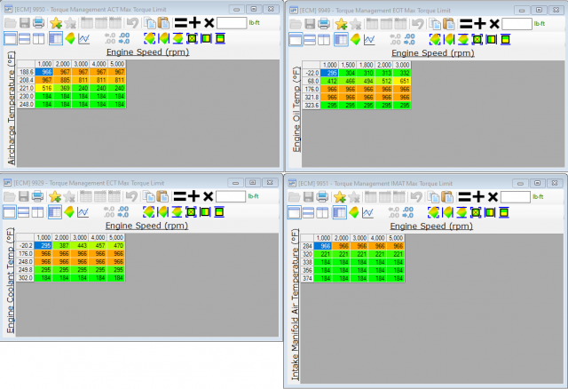

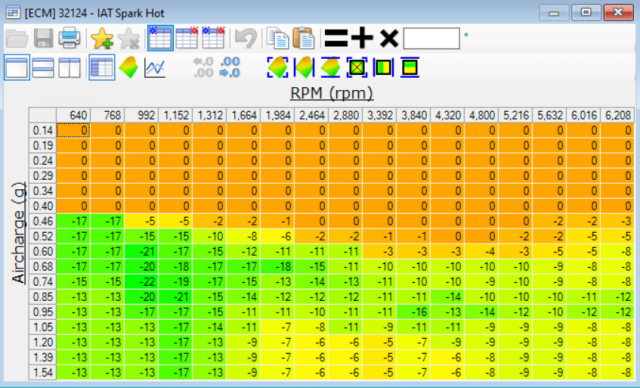

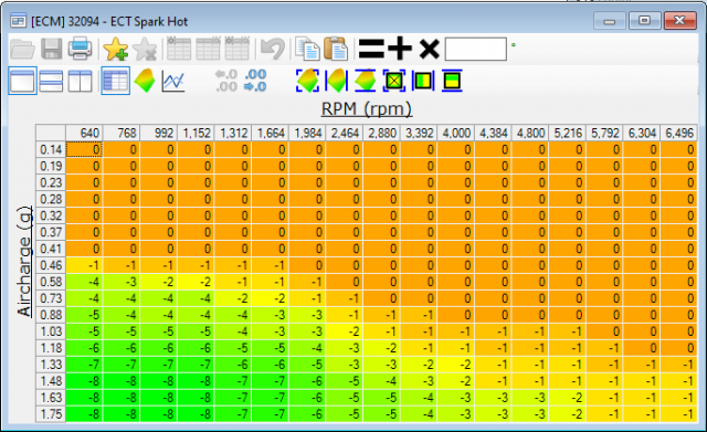

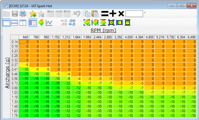

Here's some data for you guys to chew on. Factory tunes too cold pulls power as does too hot. In terms of IAT it'll start pulling power progressively as IAT approaches 212° F. A standard Hellcat will pull a max of 6 deg and a RE 10, but remember it won't be max until 212° F and if your IATs are that high you got bigger problems. What I'd be curious about when looking at a CAI vs stock air box would be what the aircharge reading was in a log. That's a direct measurement of how much air is going in to the engine. If a CAI has higher aircharge then it's letting in more air. THEN you have to worry about temps and all the below I think. Factory tunes have all kind of nannies so it's going to be a bit harder to really test something like this. Cat over temp is probably the first nanny you hit on a stock car and it kills power on these things with a low 10 AFR.
From a 2019 RE:
It'll also pull a bit for engine coolant temp. The reference hot ECT temp is 244.
2019 RE ECT Hot Table:
Then you have torque management that'll kick in at various temperatures. Oil temp is one where if it's too cold it'll hold back power so running a car cold off the trailer you probably won't run as good as one with warm fluids.

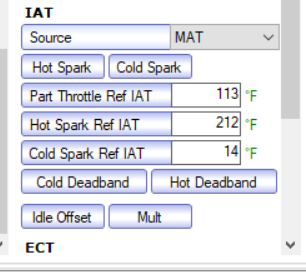

I've been trying to figure out the difference between IAT and MAT on these cars. I doubt it is much but that is what the stock file goes off of. It can be changed to IAT. My understanding is Coolant temp and IAT adjust to create the MAT temp. MAT will read slightly higher.
My first LMI pass and stock box only has about a 1mph difference. That small of a difference could have came from anything.
Hellcat stock IAT/MAT hot table
