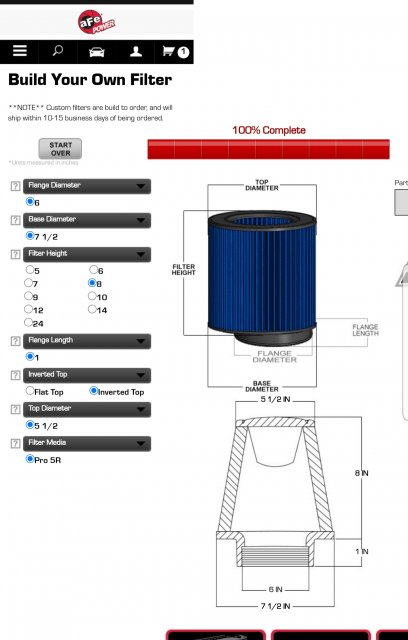

I already looked through Green I don't like the solid cap. 2382 is close
Afe..

For some reason AFE will not let me build a filter. It gives some ridiculous price. Must be lack of employees due to government handouts..
