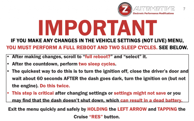

Yeah it's a computer interface after all using canbus commands (I assume) so I can see it requiring a specific sequence.
The only problem I've ever had with mine is it losing the button programming. I'll go to use the line lock and nothing happens. I quickly re-program and moved on with my day. I had been thinking it was due to flashing a tune in the car but never looked in to it since it's so quick to just re-program but I may need to look at doing the above.
I'd love a way to disable the light shows so I don't have to scroll through them when setting up the steering wheel buttons. Anyone figure that out? The only things I use are the line lock and cool down.
