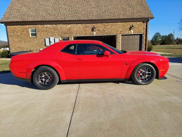

Weight is out. Car is loaded and ready to head to Houston tomorrow.

Car looks amazing as usual. Can't wait to see this thing run.
Thanks Ron. It'll be fun to get some 1/4 mile laps on this thing. I hope it runs good.
