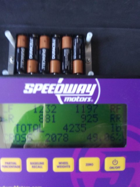

Put the car up on the scales again after some easy weight reduction. Front sway bar and hardware, drag pack f/r tires/wheels, removed everything from the trunk, and 1/2 tank of fuel. Sorry for the blurry pic. Since this pic was taken, I've swapped the battery to a Darrel Cox lw lithium. Weight should be 4199 lbs. now.

Looks about right.

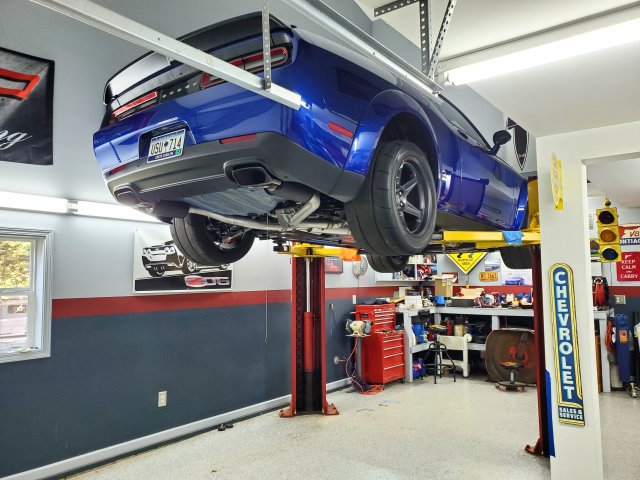

Back from the dead - what lift is that, how high does it go, and how high are your ceilings?
It's a Mohawk A-7 (all made in USA), columns are 8'3" tall instead of the usual 9' on most others. It's also all hydraulic so there are no cables to break/snap. The lift arms raise to 6'. My ceilings on the lift side are tall though, 2 stories. 20211014_154233~2.jpg
