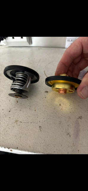

My '22 Hellcat is just under 3K miles and 2.5 years of ownership. I've noticed on more than one occasion, and most recently when I drove it the other day, the coolant temperature varying significantly. I typically drive it with the gauge dashboard on displaying oil temp, coolant temp, IAT and transmission temp. Daytime temps here are currently in the high 70s/low 80s.
My mods are in my signature and the only engine modification is an OCC, no tune, etc. I don't recall the exact temperature of the stock thermostat but thought it was 200 or something...? The temp sweep of the gauge is 170-260 and the 12 o'clock appears to correspond to 215 degrees.
The other day I was on the interstate for 10 minutes or so when it appeared to fluctuate rather wildly, and hit 2 o'clock hashmark/230 degrees momentarily before rapidly dropping to the 11 o'clock/200 degrees then back up to the 12 o'clock/215 degrees. Cruise on, constant speed, minimal load increase, etc.
I've noticed it do this before and found 220+ readings to be rather alarming, especially when I'm not doing anything remotely demanding. The rather wide and abrupt temperature fluctuations have me thinking it's a wonky thermostat, but was curious if anyone thinks it could be something else.
Both reservoir levels are where they were when I bought the car and there's no discernable loss of power, etc. Just the coolant gauge doing a jig while all the other gauges are reading nominally.
I know there's no benefit to swapping out to a lower temp opening thermostat without the benefit of tuning to adjust the fans. It gets crazy hot here in the summer, well into the 100-teens and seeing this happen the other day when it's relatively mild out was a little disconcerting...
