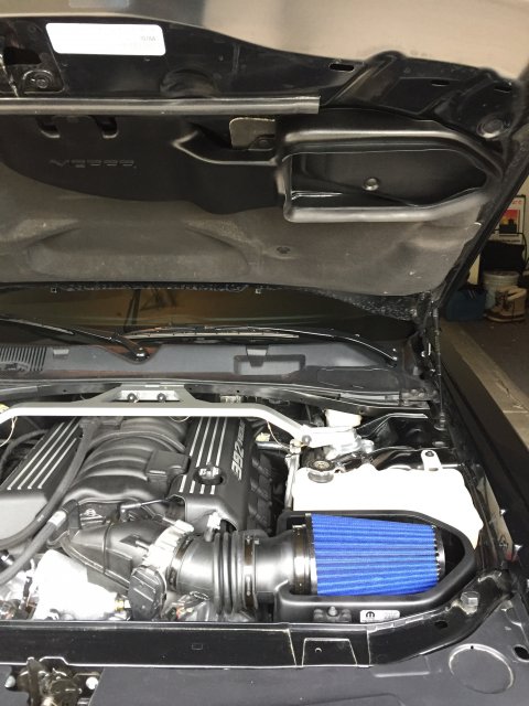

Hey guys. I bought my 2015 challenger SRT 8 2 months ago. It had the K&N cold air filter. My question is if I want to use the air induction from the demon hood, will I need a hell cat stock airbox? I also would like to connect the induction tube from my headlight into the lower airbox. The K&N cold air box is open and probably does not receive the air pressure from the hood or headlight tube. Would this even make a difference?

Technically if you have a ’15 it will be an “SRT392”. I installed a kit for my ’15 SRT from the R/T intake offering. Works real slick pulling air from the hood scoop. Comes with the headlight port air and air from the wheel well. Should be able to find a kit with a quick web search.
