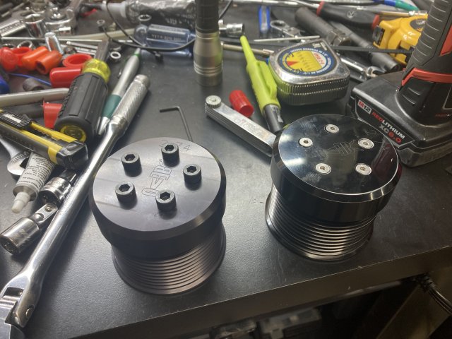

Satera Rings of Hell pulley up date. Seems they have had some concerns over the method of bolting the rings to the clutch, even though mine had no issues they sent me a brand new one no charge with a prepaid label to send the original back. Now that’s TOP NOTCH watching out for product satisfaction!! I’ve still months later never got a certificate from Litens for 50% off one boy even though I sent three back. I highly recommend this Satera pulley over a Litens not only because it works snd stood up to my abuse but also because of Satera’s TOP NOTCH customer care! 👍🏻👍🏻
THANK YOU Jeremy!!
So I have a brand new Pulley to put on a IHI if needed in the future, NICE!!

Or you could sell it to me lol.. nice! I wish whipple did that! Got IN FRONT of the problem

Satera clutched pulley for my Whipple should be here in about 2 weeks 🤞🏻

so that was not one in the picture from them about being a tester?

Unfortunately no, they’re not ready to ship yet. I thought it was, until this pulley arrived and I called them about what is this lol. Then they explained the situation. Test pulley hopefully be here by months end.

really interested in a clutched pulley for the whipple, I assume your testing one of these for them.

Yes, I’ll post pics once it arrives.

Outstanding customer service and a decent vendor to deal with

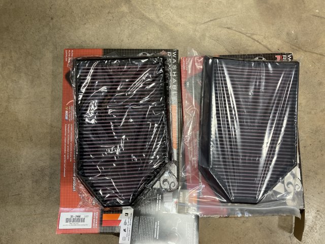

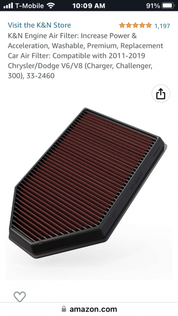

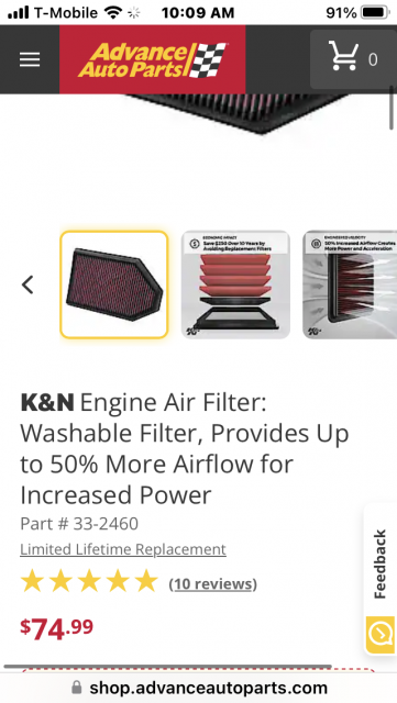

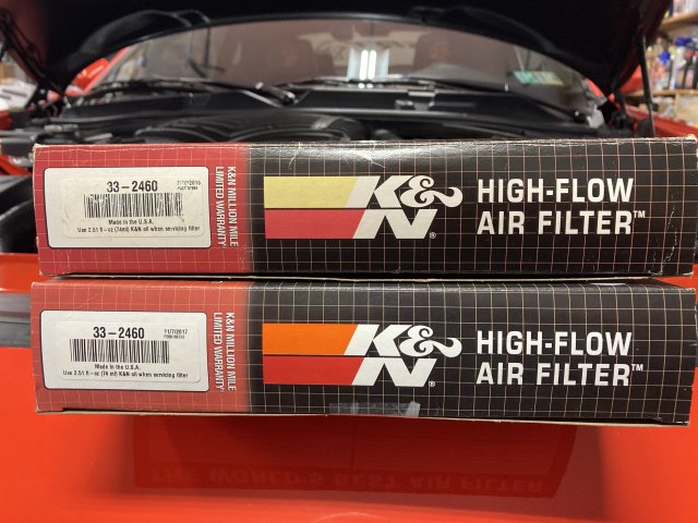

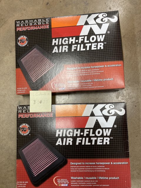

K&N filters for sale in the for sale section,$120 for both shipped.
