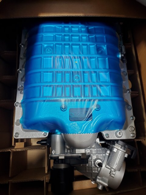

And the Whipple finally returned yesterday!!! Yaaayyyyy. They replaced the complete compressor section and rotors with new parts, basically a new blower. Still a J Rev but they’re calling this one out as a Pinned model, Hmmmm. Did a quick inspection behind sealing it back up, rotors look a bit different and it has a scraping sound when rotated. I’ll post a video on it, sounds much worse in video but it doesn’t turn buttery smooth like a IHI blower does, no rattling at least. I called Whipple today and they told me that is the coating of the rotors rubbing and is normal and will run in and create an almost perfect seal, we shall see but unfortunately won’t know for at least 6-8 weeks till I’m running again :(
They even returned my super magnet drain plug in the new rear gear case :)
View attachment 90708 View attachment 90709 View attachment 90710 View attachment 90711 View attachment 90712 View attachment 90713
I wouldnt be surprised if I have issue next year with the others failing. You have any issues with sending it back for them to fix it? Has to be hurting them fixing them all

I'm keeping my stock blower just in case I have to put it back if I have to send mine back
Nope, no hassle. I called them Monday -Tuesday asking it’s status, they told me Bevin inspection in the next week or 2. 2 days later I got a shipping notice it was on its way.

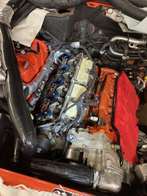

Sooooo, on to the passenger side head removal :)
