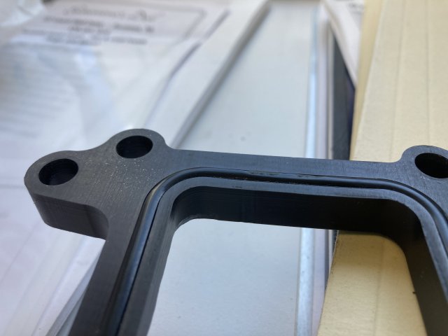

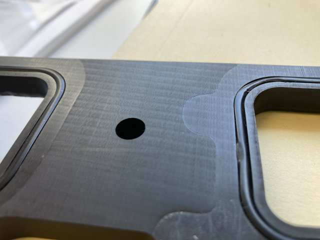

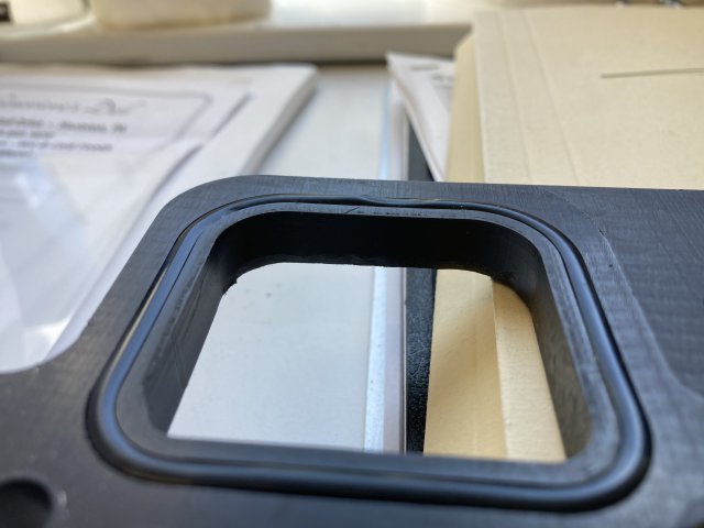

So last night in cleaning and inspecting my FI insulator plates before setting the blower in place I noticed some irregularities to the sealing orings around the ports, predominantly on the end cylinders, worst on cylinder 2 which had the darkest looked rich spark plugs. I think these are witness marks of boost blow through. I ordered new orings today that will be here tomorrow so setting blower in place won’t occur until Saturday AM at best. (Wife wants to go for dinner and drinks tomorrow night). So tonight I’ll get the coolant lines sorted, insulated, and wrapped and be all prepped for Saturday AM putting the icing on the cake.
View attachment 80015 View attachment 80016 View attachment 80017 View attachment 80018
just flip them upside down so the bad side is on the inside:)
I did that lol, still looked as shitty, like it was extruded out of the slot.

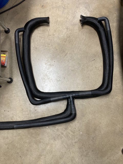

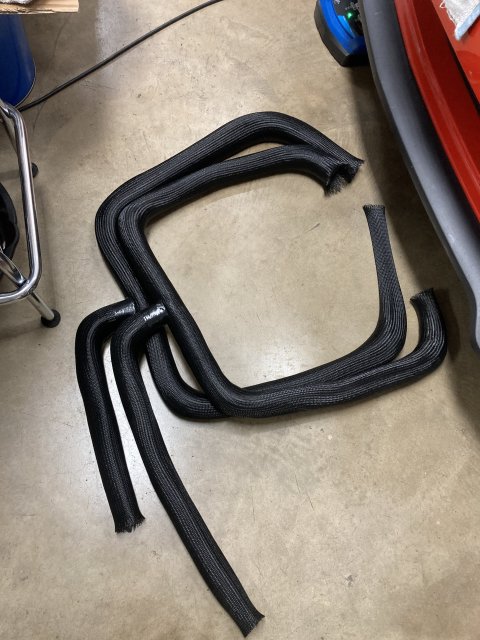

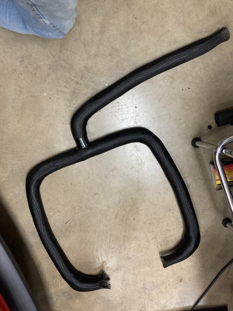

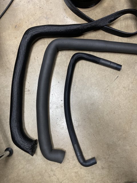

Who would think you could spend 4 hours on insulating 2 coolant lines lol. Was tough getting that 7/8 ID foam over that over braid on the hoses but I didn’t want to take it off, I will give a air gap between the hose and the insulation ID and add a tad bit more insulating quality to it all.
